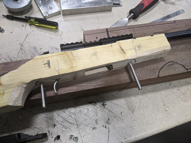

Put a lot of hours into the program tonight. Programmed and cut a test out of a 2*4 from the workshop scrap pile.

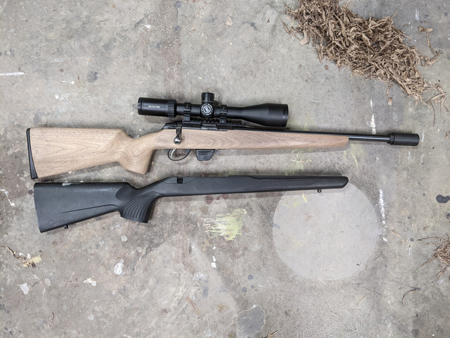

It would've been a lot easier if I was just lazy and did a giant swimming pool cavity that Tikka does, but this is way harder and makes me feel a lot more satisfaction.

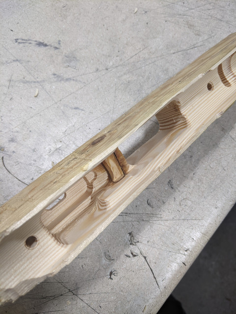

I turned some rods down to the M6 minor diameter to align the action and bottom plate. I'll need a blushing to go up to the bottom plate hole size, and can mark an exact location for the recess. I'll probably also have to do some internal relief work.
I ensure the action fits snug first, then add the magwell to check clearences. Then add just the trigger and repeat. Finally the entire assembly is test fit.
Should I be putting steel pillars in here as well? I can't help but think the recoil lug (which I'll also have to make to 0.246") is isn't going to be enough of in own over the years.
Don't forget the little shelf in the inlet to hold the bolt release pin in place. Actually need a wide shelf for T3 as well as T1, T1 needs a wider shelf. We just finished our new T3/T1 stock design and added that feature.
edi
edi
Not sure I fully follow. I don't see anything that needs to be added and everything fits.

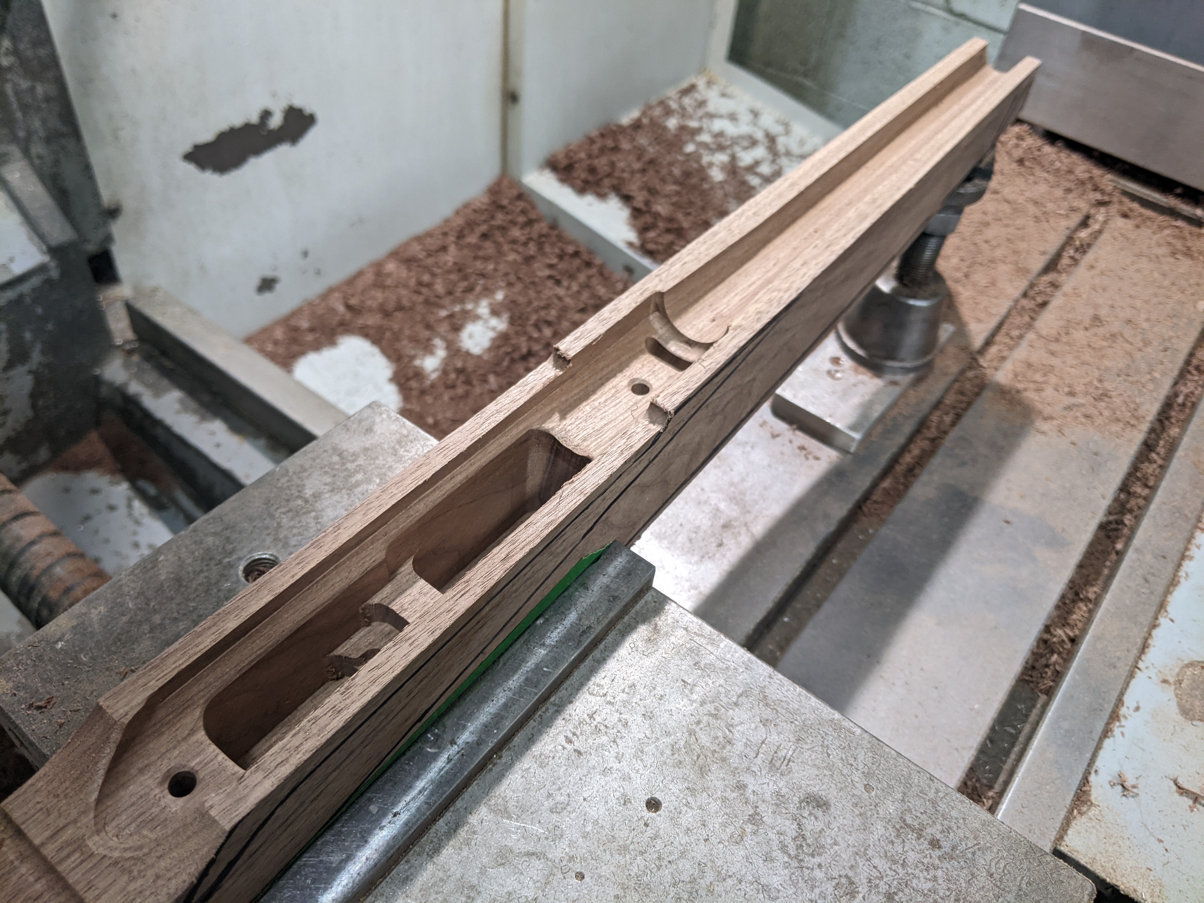

Ran the walnut after some slight tweaks to where the bolt-end of the action sits. Tika actually side mills a profile into the end of the receiver.
Im going to only worry about carving all the wood over the holidays, then when I return i may open up the holes for steel pillars as well as make myself a Ti recoil lug. I think it'll be one or the other though in terms of necessity.
I did a quick google. Would the pin holding the bolt release ‘button’ start to slide down over time if there isn’t a physical shelf to hold it in place? Compare the bolt release area of your factory inlet to yours where you have cut away material. You might see something.
I "see" what you mean, but a push pin a) shouldnt come out and b) won't fall down far enough to disengage with this inletting.

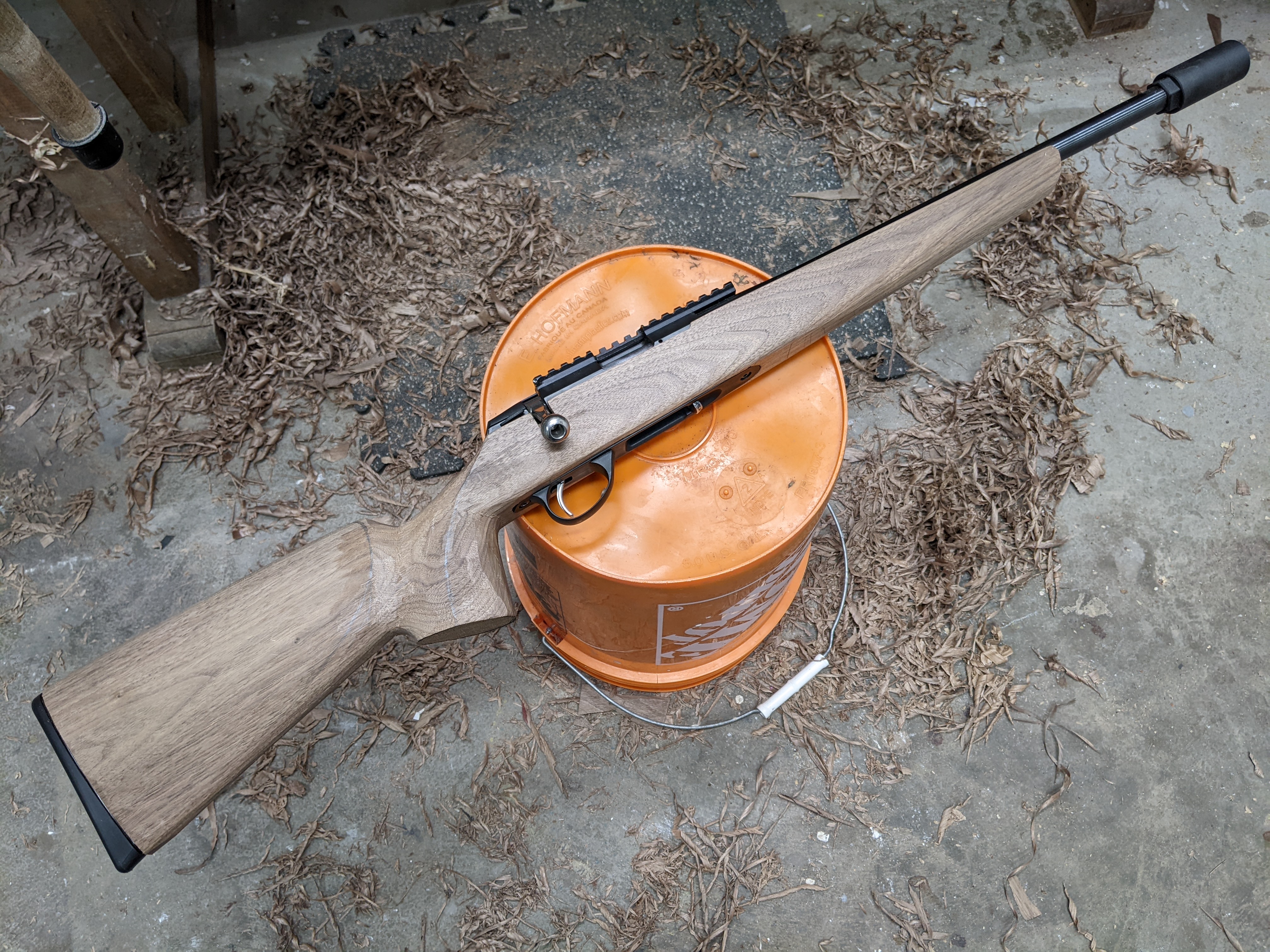

This is as far as I got yesterday before the family started to want to spend time together. Hoping to get some time in tonight or tomorrow. I'll 3D print myself a buttpadd in the future.
That looks fantastic! Wonder what it would look like with one of the flush 5rd mags.

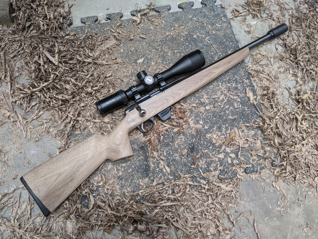

I have a CPRS shoot this weekend (the only one this year in NS!) so I got my butt into gear and did some quick sanding to 150 and stipled the grip with my dremel and a ball burr. Mag base is printed. Scope lever is printed. Going to have to print out a buttpad tomorrow and maybe a cheek riser.
