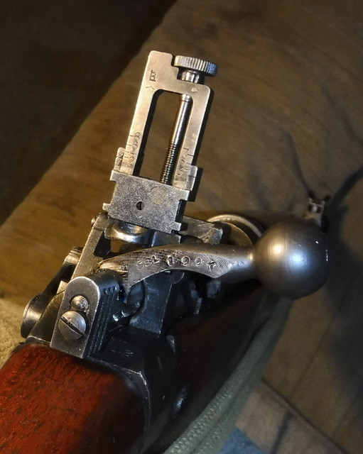

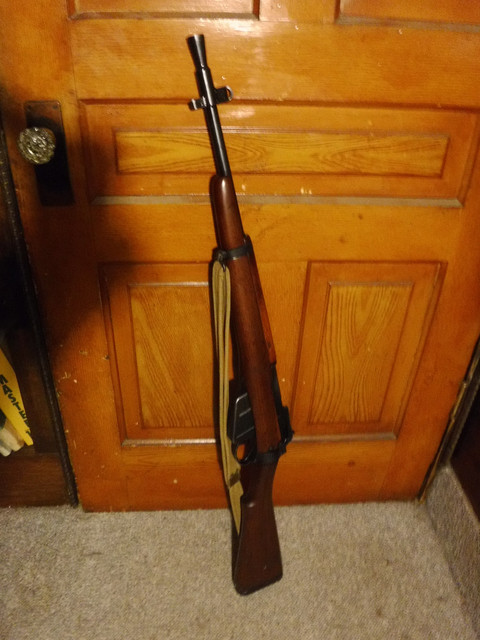

With milsurp prices going the way they’re going I’d like a price check on my No.5 Mk.1*Jungle Carbine (sorry I haven’t been keeping track of prices) and may have to download a few items to pay covid expenses.
See pics. 1944 dated, complete and all original (flash hider with lug, 800 metre sight, etc.). Matching, like new bore comes with period sling.
Any help most appreciated.
Enfield variants are surfacing from collections that were assembled decades ago. Recently I 've had the opportunity to examine 3 rare Long Branch No4's.....a CNo67, a light weight and this "Jungle Carbine". Shortly after after acquisition the Collector arranged for me to visit with the intention of examining the rifle. Here's what I observed;
Barrel - '44 marked on the right side of the knox form. 4 symetrical lighting cuts on the knox similar in size to the Britishicon No5. Barrel was lathe turned to meet the diameter of the flash hider. Flash hider appeared to be British. It also had a lathe turned finish and no markings. Finish was Long Branch bluing.
Bolt - Numbered to receiver.The bolt was identical to the forged Light Weight profile. Handle was swept forward and hole drilled in knob for ligthening. It was compared to a light weight bolt and was identical except the numbering.
Receiver - 1944 Long Branch marked. No evidence of serial number ever being removed from butt socket. Contact number stamped on sn location with rifle number. Right side below had the reinforcement block just behind the receiver milled off. Above the stock line there was a lighting cut at the rear lug similar however smaller than the British No5. Left side had the dish cut just ahaed of the safety identical to the Light Weight. The under side was more interesting......the draws and the flat section forward the draws was milled for weight reduction identical to the Light Weight. The receiver had be case hardened due to amount of material removed and was showing the "purplish" hue that you only get over time.
Stock - Jungle carbine profile in Canadianicon Long Branch walnut. The forend was one of a kind. Two lighting cuts in forend ...one long and one short...do not line up with standard No4 cuts. Receiver inletting was tight, no fillers. No evidence of a British rework. The tie plate was Long Branch. The machine cut was idectical to what we see on LB stocks...special tool needed for this. Butt similar to a Brit. No evidence of a rear swivel in fill...very unique. Pad metal housing was not marked, components were phosphated. Inspectors mark on wrist as shown in Cantom's pic's.

It also has the early fore stock, before they added the metal caps to stop them from splitting. Check the lightening cuts inside the fore end.
Those would be very difficult to duplicate if the the stock is indeed a LB stock.

The rear sight in the picture appears to be a BSA No5 rear sight which has been overstamped with a fake Long Branch cartouche.
