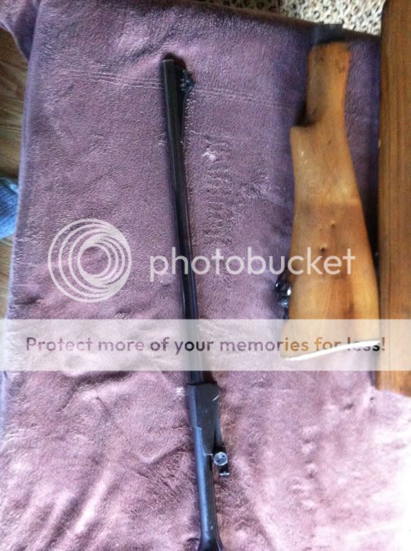

Hoping to get some help with this Enfield. I got it from a guy about 40 years ago and has been in storage for about 30. Took it shooting a few weeks ago and still shoots great. It had a 4 power Bushnell on it when I got it but I never used it. Not going to do anything to it but shoot it. Would just like to know what all the marks say about it. The only number I could find on the magazine is a 4. Took pictures with iPhone and some are not real clear.

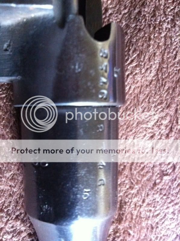

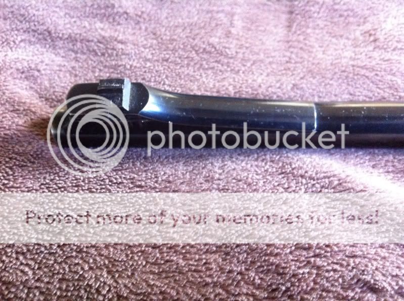

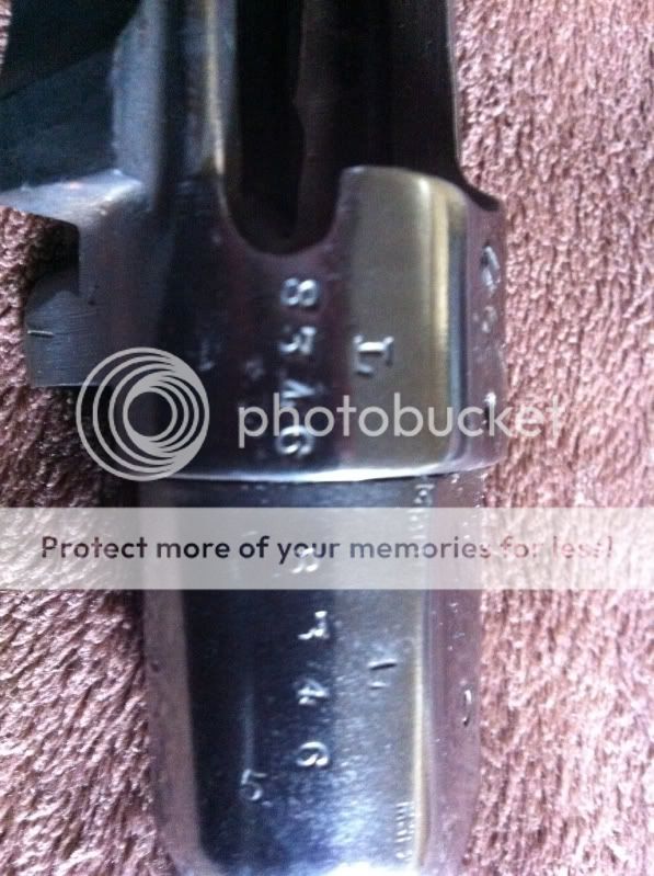

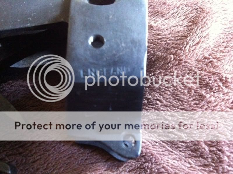

Your SMLE was made at the "Royal Small Arms Factory", located at Enfield Lock; that's why there's Enfield stamped on the right side of the receiver, with the year of manufacture. Looks like a commercial sporter, given the nice front sight ramp.

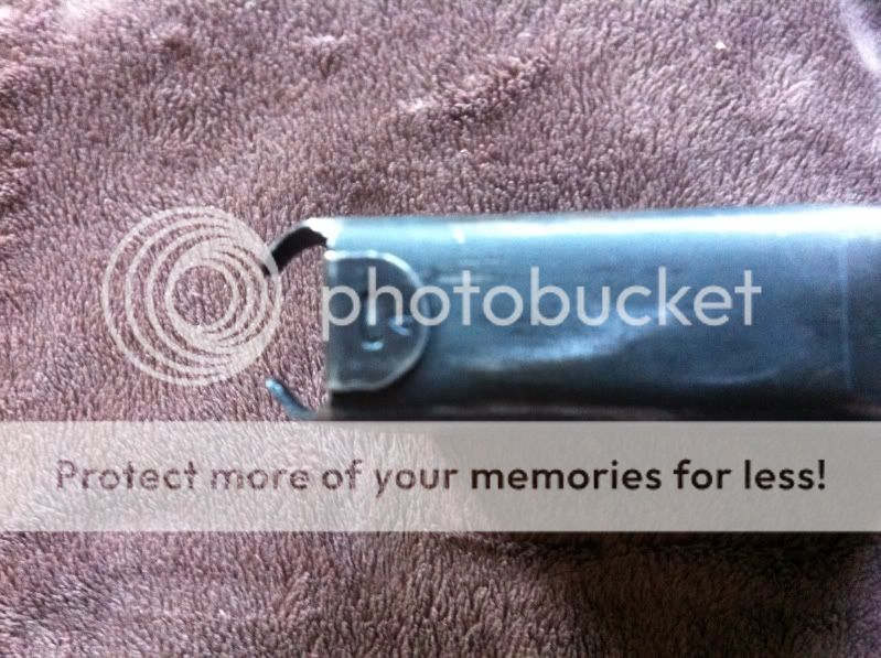

The serial number is stamped both on the front of the receiver and the barrel, right next to it. The "4" on the magazine is simply the 4th version of a magazine for the SMLE. Seems that you're missing the safety?

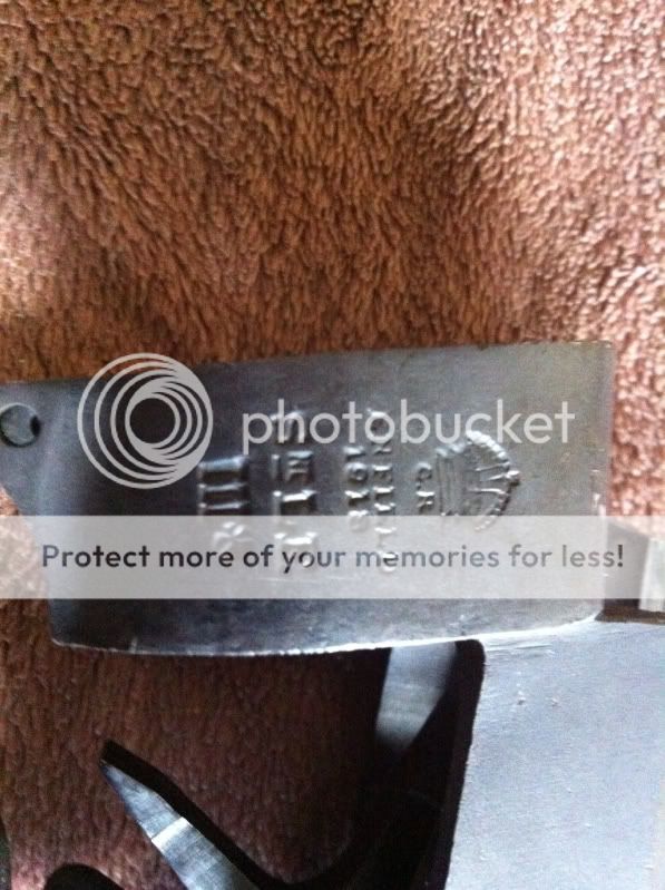

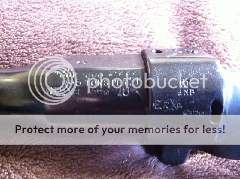

The markings I am most interested in are in picture #5. Can anyone explain those to me.

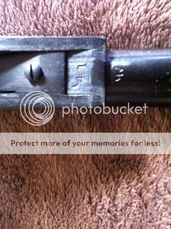

The mark on the receiver with th crossed lances are british acceptance marks. THe mass of numbers on the barrel "303 (calibre), 2.222 and 5 tons are proof marks stamped after sold out of service, proof of pressure test. "BNP" is for export stamp
Are there any marks that indicate when it was made into a sportster? Or did they do that at all?
Markings in Pic 5 encompass about 40 years of this rifle's use, from the day it was made to the day it was sold off surplus.
Your 'crown-crossed-flags-GR-P' on Body ('Receiver' to the Americans) and Barrel are Government proofs from when the rifle first was built. You also have an Inspector's PERSONAL punch mark there to attest that HE checked it.
The '18 is the Barrel Date; this barrel was installed in 1918 and so is the original.
NOW we come to the post-War-Two markings which were applied when the rifle was sold off. These were applied at the Birmingham (commercial) Proof House and amount to a re-Proofing of the rifle, from scratch. 'Crown-BNP' is the marking, Body and Barrel, for 'Birmingham Nitro Proof'. .303" is the BORE diameter, 2.222" is the LENGTH of the casing, "18.5 TONS/" square" means that the rifle was tested with an overload and approved for a working pressure of 18.5 Imperial Long Tons (2240 pounds each) per square inch for a total of 41,440 pounds per square inch WORKING pressure.
