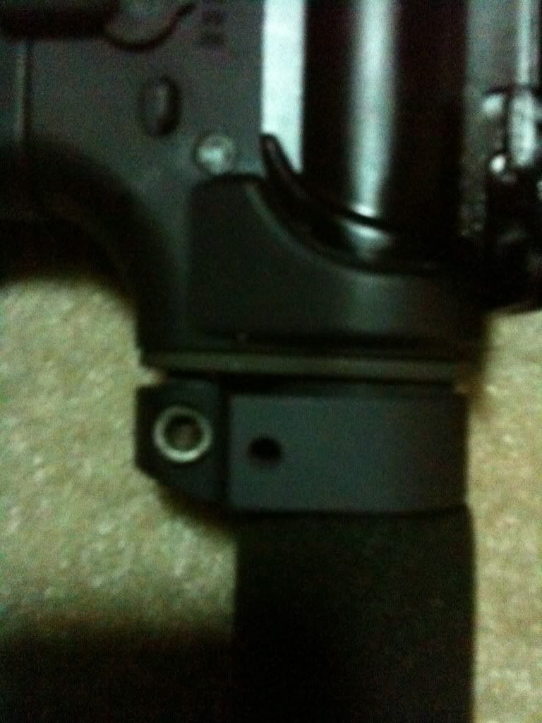

Ok got it all together and everything seems ok, except, should there be that big a gap between the tension lock of the stock and the receiver end plate?
Throw the end plate into your spares pile. The ACE stock does not need one and will not work with one. The clamp (aka "gusset") goes directly up to the receiver, holding the takedown retainer pin spring (if thats the right term) in by itself.
If the nubbin on the gusset does not fit easily into the receiver, then either the receiver or the gusset is out of spec.

Ok, so the nubbin on the gusset is a wide oval, where as the blueline lower has a more round indent. How do I figure out which part is out of spec? Can anyone show me pics of nubbin on their gusset? Or a pick of the end of their lower receiver?
Thanks for the help acrashb, now it's just a matter of figuring out which part needs replacing
Ok so then the nubbin on the gusset should be able to fit inside of that? It does not it is much wider than that hole in the end of the receiver. So I should contact ace and get a new one? Anywhere I can see a pic of the nubbin on the gusset?
ok thanks acrashb i got it working. the nubbin on the gusset was exactly .499, and the blueline lower was just a hair smaller at .497-.498, so i introduced the gusset to mr. rubber mallet and success! so thanks for all your help, problem solved
