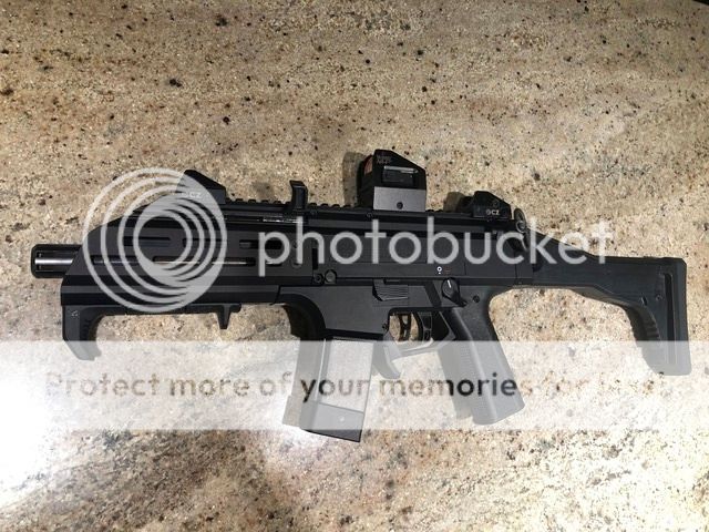

I just picked up a scorpion evo and it came with a TRS-25 red dot on it, in the typical low mount set up (co-witness with irons). I have instantly fallen in love with the gun. To make it better I figured I could put my fast-fire III red dot in its AR height AR-F3 mount (link to pic below). I took this off my AR and it looks good on the scorpion and fits me perfect for the way I want to shoot it. I can even use the irons through the mount under the dot. One problem - the optic does not have enough adjustment on the scorpion to hit POA - maxed out for adjustment it hits 8" low at 15 yards.
I suspect the Fast Fire does not have enough adjustment because they are typically mounted much lower (most do not run the AR-F3 mount), and the scorpion has a greater difference between the bore and optic mount then my AR.

https://i3.photobucket.com/albums/y83/platnumbob/E0EB1E52-77A4-4ED6-8B3C-D785AEF16C83.jpeg
https://s3.photobucket.com/user/platnumbob/media/E0EB1E52-77A4-4ED6-8B3C-D785AEF16C83.jpeg.html
