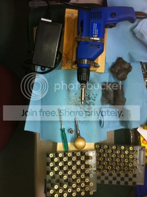

In my case I was looking to speed up my case prep as it was taking me way too long by hand. The Lee Zip Trim helped but it still wasn't fast enough. I picked up a Princess Auto drill on sale for $20, threw on a Lee 3 jaw chuck ($16), a 120V foot controller from Busy Bee ($25 on sale) and I was off to the races. I chuck a case, trim it using the Lee cutter, chamfer/deburr in one step with the Lyman tool, brush out the inside, steelwool the case (clean/polish), then wipe down the case all in one shot. Beforehand, I clean the primer pockets using an old battery drill with a wire brush bit for a dremel tool. After using this setup, I really can't see spending over $100 on a handraulic tool.
