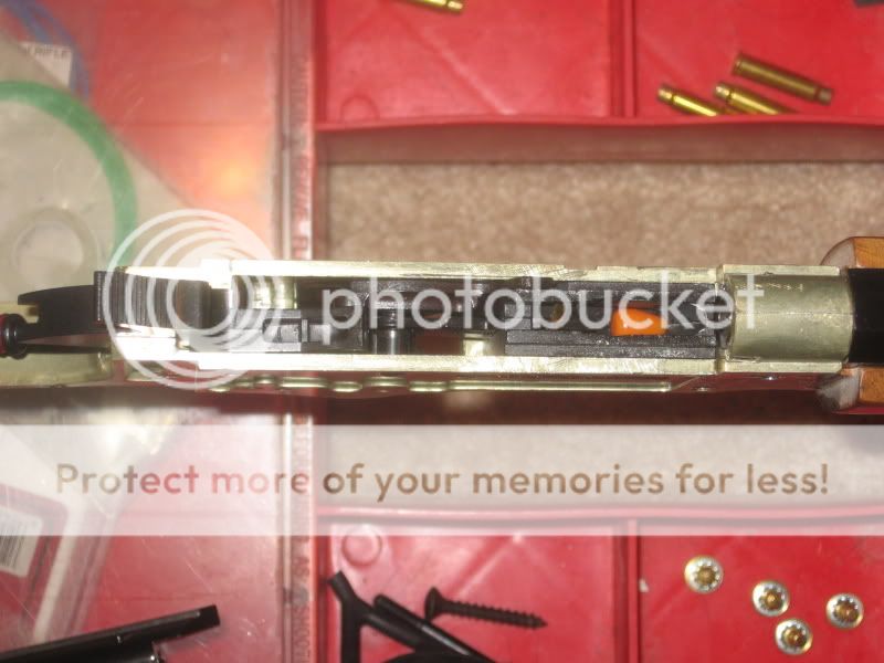

Here are some pic's of the inside of a Henry. Took mine apart. Fairly simple to put back together.
This is a picture of what it looked like before I took it apart :)

I completely disassembled, cleaned, and lubed it up. Feels like new again! We put another 300 rounds thru her today and it still feels good.
