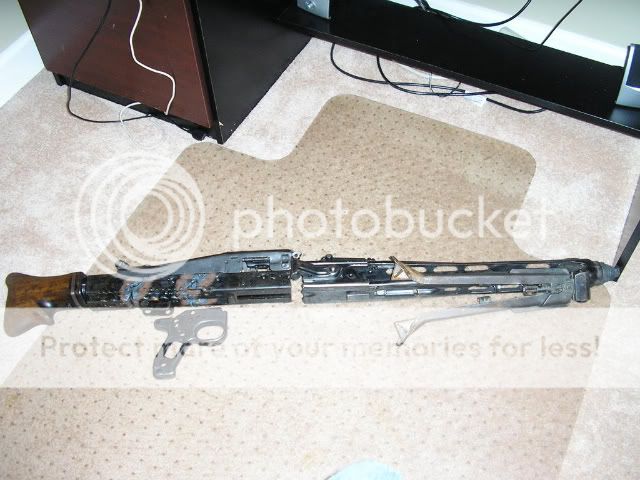

Well here is my m53 "sarac" build details. I emailed the canadian firearms center, and they said basically, you cannot use an original full auto receiver, as that would be a converted auto, barrel length and overall length to meet non-restricted requirements, and should fire semi automatically from a closed bolt when finished. Once i am complete, i shall have to also have a local rcmp officer come swing by, and make sure i have met all of these requirements.
Now that i had all that information cleared up, i bought an m53 parts kit (all parts + a cut up "legally deemed scrap metal" receiver. Only way i could get that part across the border, but it made it through customs OK :D.
This picture just shows the main stuff, i do have the barrel, grips for the handle, and all the other goodies that originally were in the gun.
As you will note, the front end is a tad bit melted, i ordered a replacement "barrel bushing", a good $150 US...:eek:. The parts kit cost me $500 us, and about $200 in shipping costs + customs (including this barrel bushing too)! Customs seems to think that they should get 25% of whatever i spend :eek:!

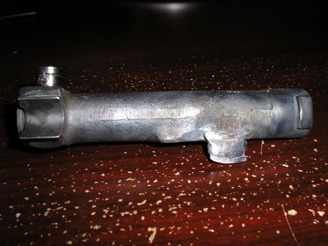

I have commenced modifying my bolt, but need some parts to complete it.
Shame to have to do that to a piece of history, but only way to get it to fire from a closed bolt. The full auto lugs on the bottom of the bolt have been ground away, so that it will not stop in the open position. That ugly little thing i welded on is for the cocking handle to latch on to. Here's the tutorial i am following:
http://www.projectguns.com/mg422.html
All in all, i got like $350 to go until i'm done, minus shipping or customs. Not sure when i'll get a chance to buy these new parts. The needed items are semi-automatic mods for the bolt, and a new fire-control group for the grip/trigger. I was contemplating using the ar-15 trigger system, but have decided to go with the FAL fire control group.
