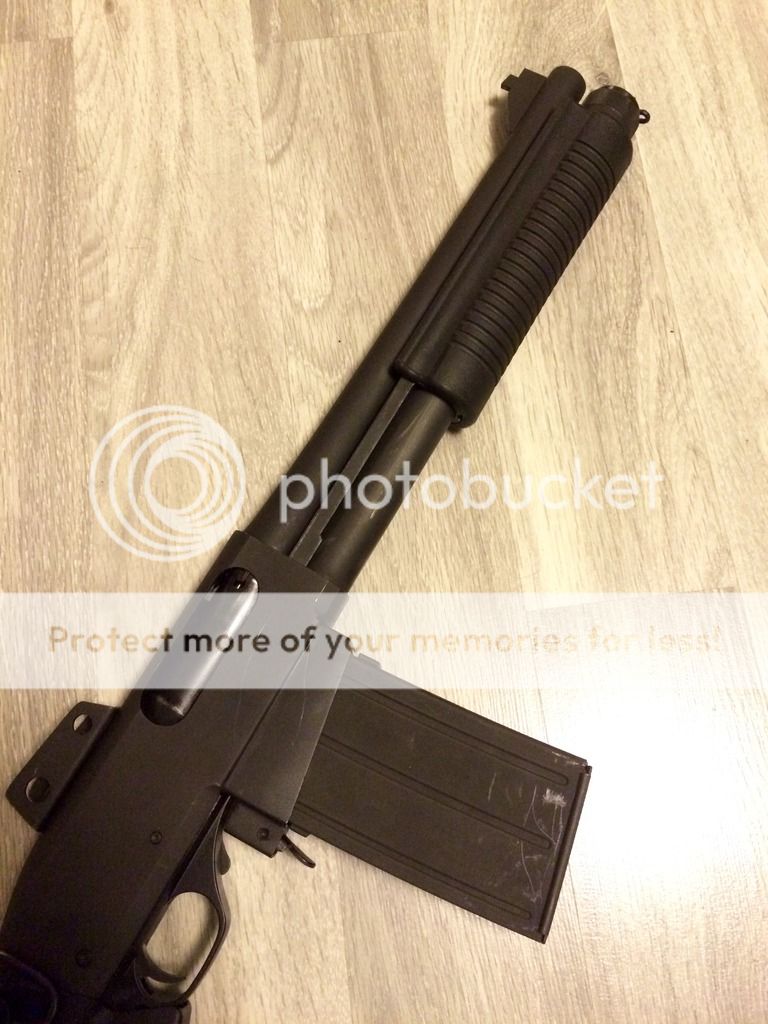

I recently picked up a 12.5" mag fed grizzly from Canam's scratch and dent section, got it running nicely with minimal fuss.

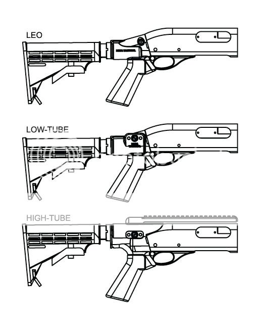

I really want to swap out the tank of a stock and have been coming back to either the Mesa tactical LEO or high tube stock adaptor/kit. I was wondering which will be the best in terms of cheek weld, my gut says the LEO will get my head low enough to use the ghost ring sights or a red dot like the trs-25.
Anyone with the either of these set ups care to comment? Are either of these hard to use stock sights or red dot without a riser? I want to keep the ghost ring sights and drill and tap the small picatinany rail for the grizzly I front of the rear ghost ring. Here's some pics of what I mean.
LEO^^^
High tube^^^
Alternatively if the high tube is low enough to use a red dot without a riser then I can mount a full length rail and any combo of red dot, sights I see fit.

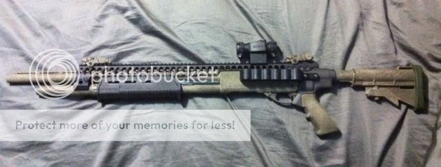

I was gonna post a pic of mine for reference but you already have it. (Last pic) Lol I love the high tube. But you need sights as it's too high for stock sights. I pulled the red dot off and I'm just running the irons now. Best way to describe it is it feels identical to an AR. If you have any questions about it, feel free to ask.
That ones yours? Lol, I've been saving pics to look at while I've been thinking about gong this route. Good looking shotgun, pretty sure I'll be using the LEO version though. I like the high tube but I want to be able to use the ghost ring sights it came with plus a red dot. I just need to figure out if it will keep a 12.5" grizzly in the non restricted length class when the stock is at its shortest position.
I wanted something different and I like the look, that why I got the high tube. Although there are time I wish I got the Leo. You won't be disappointed as the quality is superb.

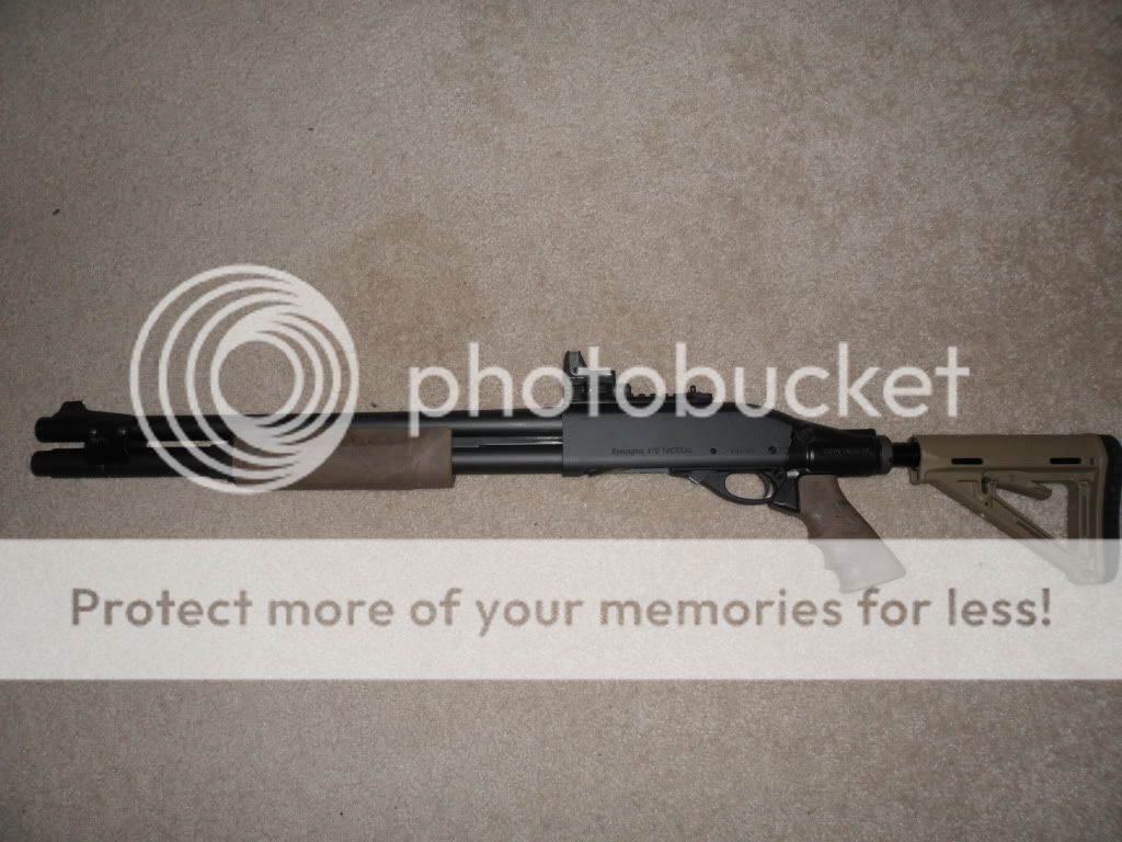

So I got my Mesa LEO stock kit today, easy instal. Had to file and sand the rem 870 police forend a bit to get it on easily, she was pretty tight lol. Man I like this setup already, for anyone interested in measurements here they are. From buttstock to end of the adaptor inline with the safety and fully collapsed I'm right at 10 5/8", fully extended it's 13 7/8". OAL on a 12.5" grizzly fully collapsed is 30", extended is 33 1/4". So well within the Nr 26" OAL for a shotgun, can't wait to shoot it.
Feels a lot lighter than how it was in factory furniture. I still have to sort out mounting the vertical grip and I need to drill and tap the reciever in from of the rear sight for the low picatinany rail I have for it. Will mount a trs-25 on it but I plan on keeping the ghost rings, cheek weld is perfect for them as is. The Mesa high tube kit would've been a bad choice with the stock sights.
