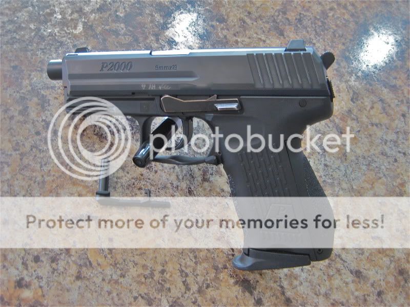

OEM slide release:

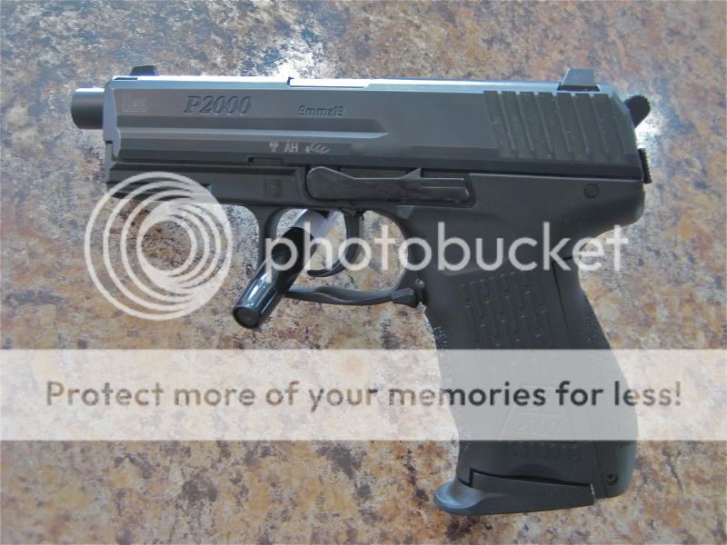

After:

Some other points:
1) Yes, I can still lock the slide back manually (in the event of a double feed, or what have you). There is still a little lip on the underside of the release and it works well.
2) I only applied the Tremclad to the outside portion of the slide release that I worked on. The rest I left in the factory finish, which by the way is much nicer than the finish on the ones that came with the pistol. The OEM units are almost purple in colour and show wear easily.
3) I can still activate the slide release with my thumb. It's harder to activate, because it's now essentially flush with the slide, but it still works. 99% of the time I come over the top of the slide to release it anyway. The only time I use the lever is when performing drills where every fraction of a second counts or if I need to lock the slide to the rear for some reason.
Now I just have to test it with several hundred rounds to make sure everything works as it should.

OEM slide release:
After:

Some other points:
