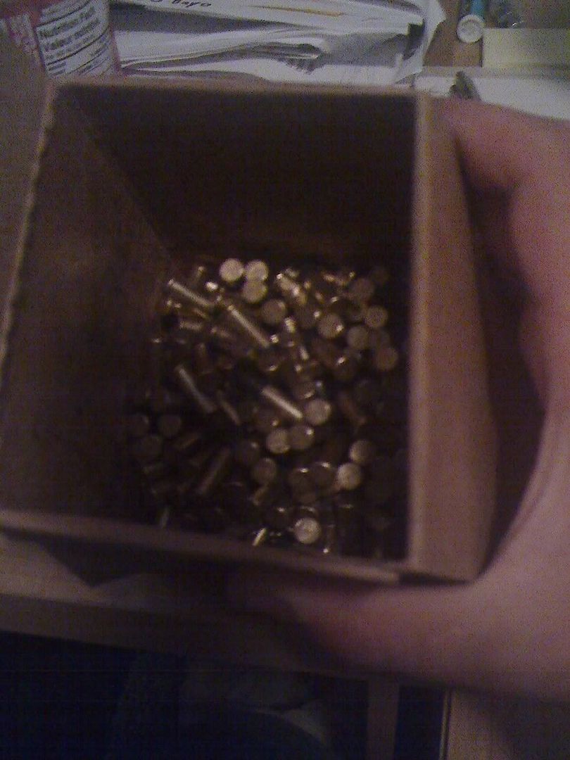

Got some good back yard range time and gopher time in with the 10/22 (LR) today.
Was shooting the Blazer (CCI) lead nose (40 grain) bulk pack, getting some nice 2.5-3" diameter 10 rounds groups at about 50 yards. Not a single flier.
Then tried some of the Canadian tire federal bulk packs (36 grain hollow point copper (plated?))
Now it was like 3.5 to 4" groups of 10, with some fliers in every clip.
Same results with the Winchester bulk pack (333 rounds) 36 grain hollow point (copper plated?).
Then tried a little box of wildcats (40 grain lead nose) and found that they were close to the Blazer's, but still not as good.
So, i was under the impression that hollow points were said to be more accurate, was I wrong?
I did notice that the gophers would have to eat 2 or 3 lead round nose before they would stop twitching, would a hollow point make this a faster job?
What could I expect from some copper round nose 22 shells?
300+ rounds shot? Not a single miss fire or feeding issue.
But I can see lead built up on the outside of the end of the barrel!!!
I guess I got some good brush work for tonight.
