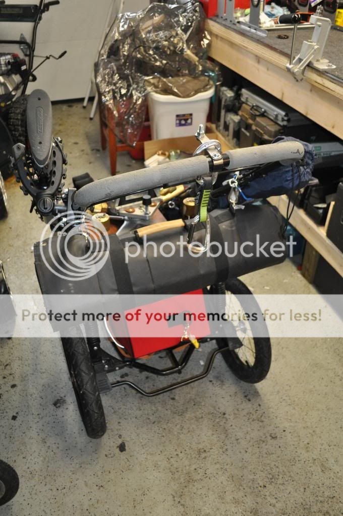

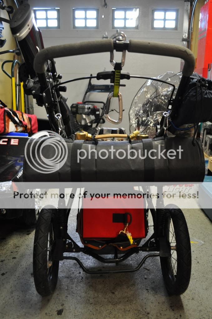

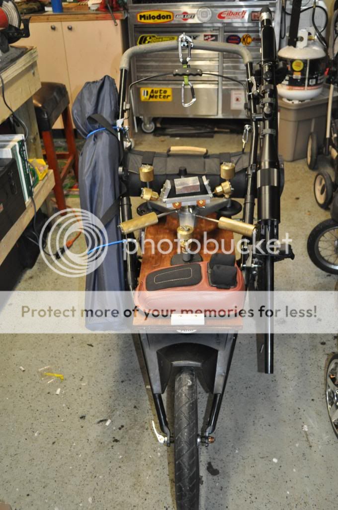

This weekend I needed a project while I am waiting for my stock to come back from airbrush. So new range cart it was this for the person on a budget and easy to build, it started life as a well used Instep jogger stroller fixed front wheel. I found the stroller for $40.00 on Kijiji, had a Basspro gift card so Kolpin ATV Rhino grips $50.00 Free with my gift card, Home depot $20.00 in threaded rod, eye bolts, bungees and carabiners. Total cost to build this unit was $110.00, and father and son time in the garage. I added a mount on the hand bar grip where my wind meter will screw onto, bungee cord wrapped around the side to hold my fold up chair hocked onto eye bolts. The eye bolts also have a carabiner on each side to hock onto my shooting mat. Kept the storage area under the cart for range box. Stained a scrap piece of plywood I had for my rest and rear bag to sit on used electrical pipe clamp to hold in place. The unit folds up nice and it came with a rain cover which also still fits to keep my gear dry when mother nature is not playing so nice.

Get a golf umbrella and slide it into your chair sleeve. By careful how much stuff you attach to the handle bars. Once you remove the shooting box and front rest you don't want it flipping over backwards with your rifle still attached.
