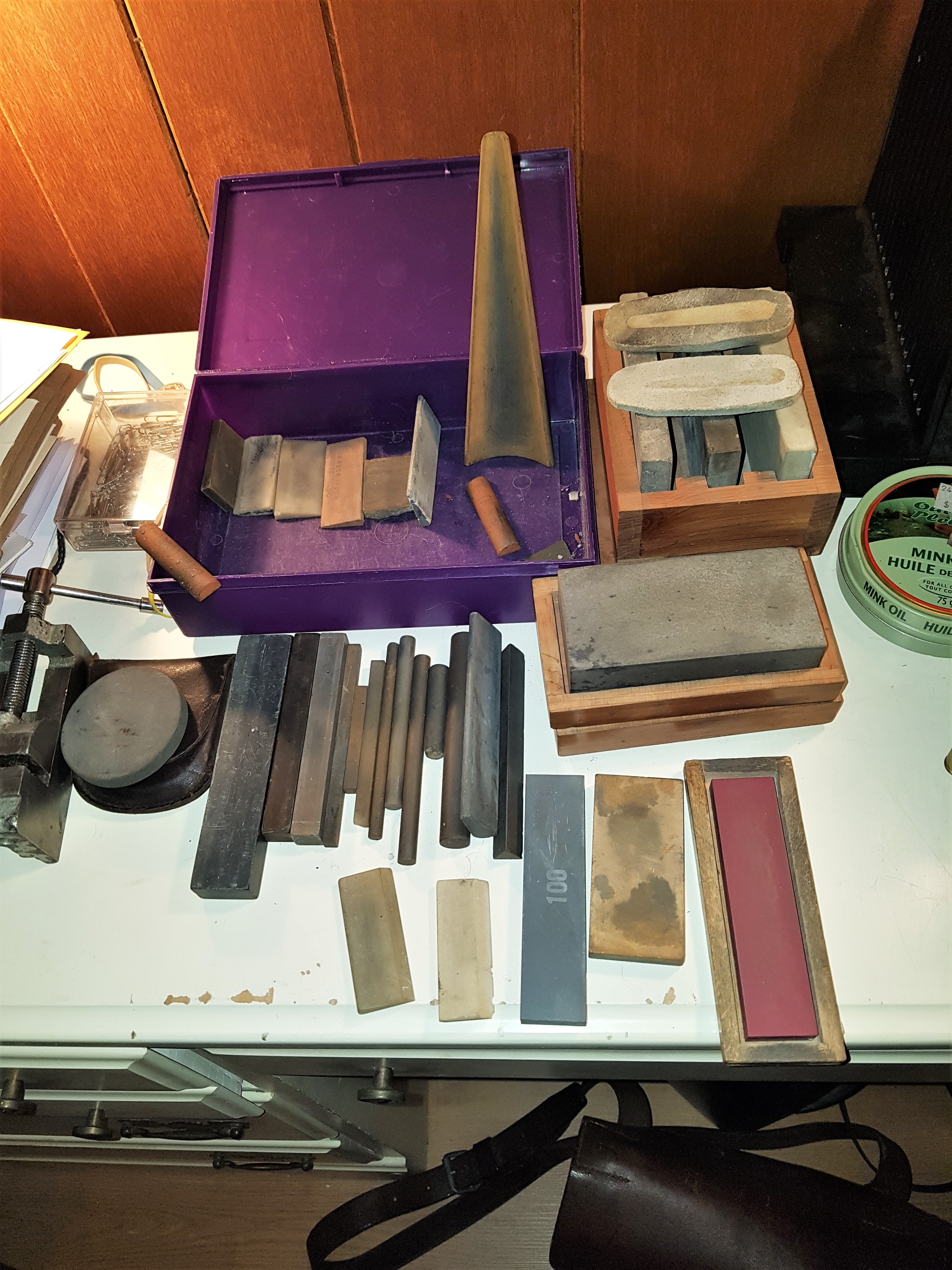

There are composite honing sticks, that are CHEAP.
They come in different grits.
To the touch, they feel like pencil erasers with grit embedded.
They're a couple of dollars each, cheaper than putting them together yourself.
They're come in just about every Grit, width, length, shape you can imagine
Craytex is one of the makers and there are several others.
These abrasive sticks wear very well and one each of coarse/medium/fine/extra fine will do a couple of dozen rifles.
You can go the more expensive route and purchase carborundum abrasive sticks but unless you're looking for something to last a lifetime and doing several rifles or even pistol rails, the composite sticks are the route to go
I use both, but only because I have them on hand. Most were given to me or came out of estates.
The composite sticks can easily be ground for specific shapes or sharp edges.
Both KBM Tools and Princess Auto carry these abrasive sticks.

No, you don't have to worry about it that much.
It's amazing how little effort it takes to remove the coarse surfaces so that the bolt slips easily over them. Unless a person is really ham fisted and not paying attention, not much can go wrong.
It's only when people use homemade rigs that don't have proper angles that they end up rounding off edges or removing to much material.
The tooling needs to be appropriate for the job.
Abrasive tools are very similar to screwdrivers for do it yourselfers.
Improper abrasive tools for the job, are akin to using screwdrivers that don't fit the slots or whatever shape they're supposed to combine tightly with.

An excuse to go to Princess Auto ! Awesome and a clever idea .
