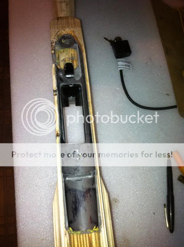

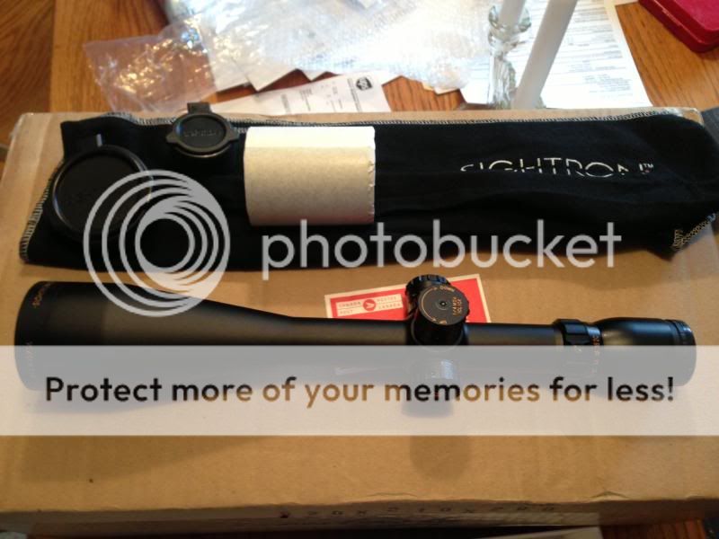

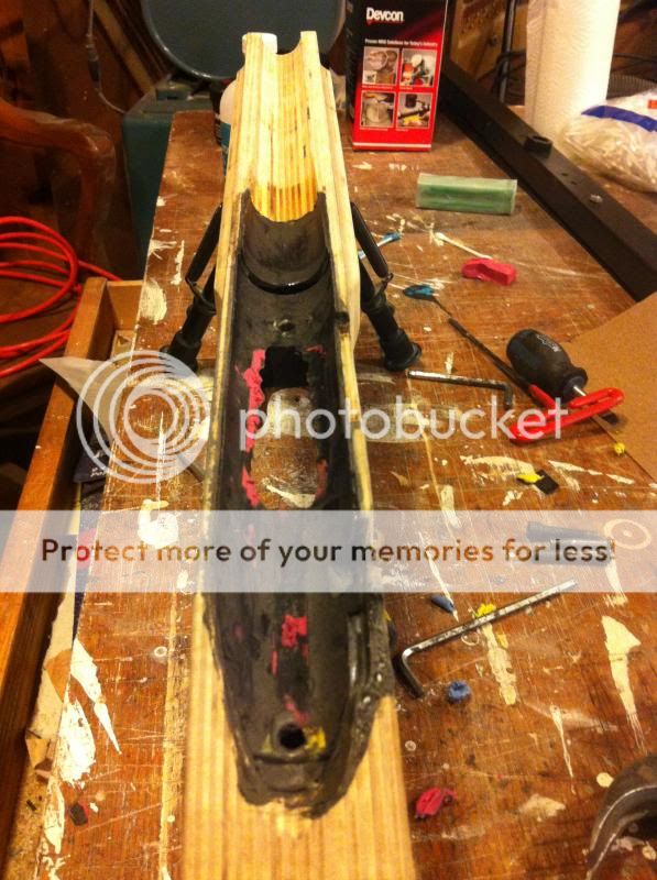

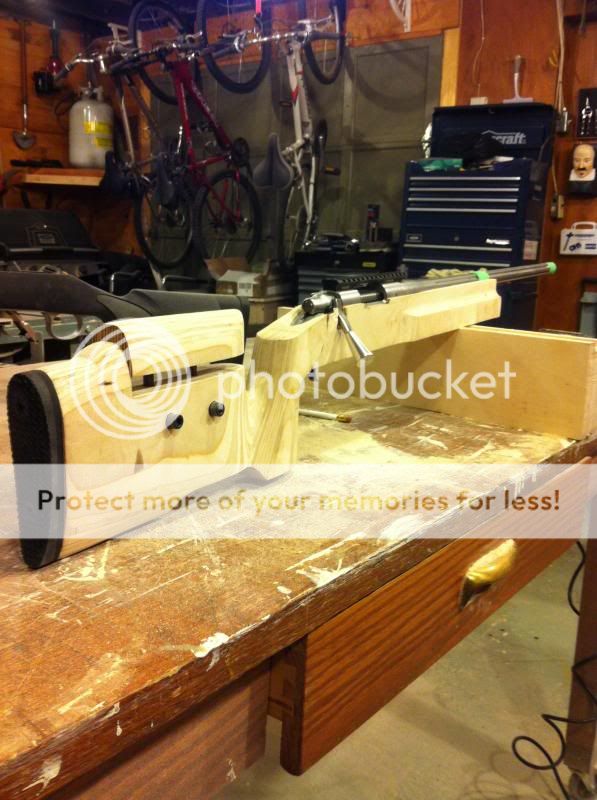

so since the last updates, i have shaped it to where i like everything. i had grizzely gunworks install a oversized bolt knob, custom made pillars. i have bedded the action in devcon (what a pain in the ass!!) everything fits nice and snug, i'm pretty impressed with myself in how straight and square everything has ended up. i have also installed a timney trigger, and purchased a sightron 8x32x56 LRMOA in nightforce ultralight rings. the bedding job turned out pretty good, its nice and smooth and fits really snug. the discoloration is because i used shoe polish as a release agent.
i wanted to get out to shoot it before i did any of the final finishing because there were small tweeks here and there to do. so heres where i'm sitting at now.

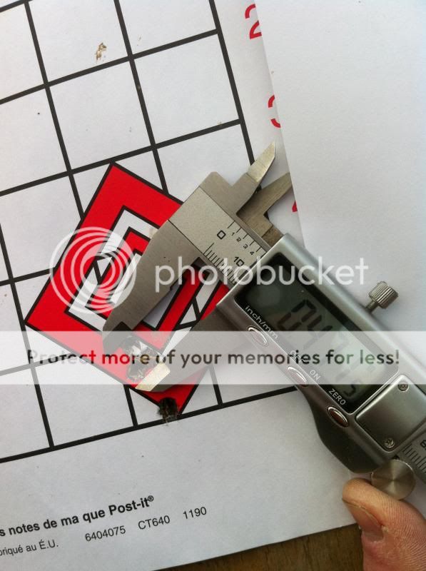

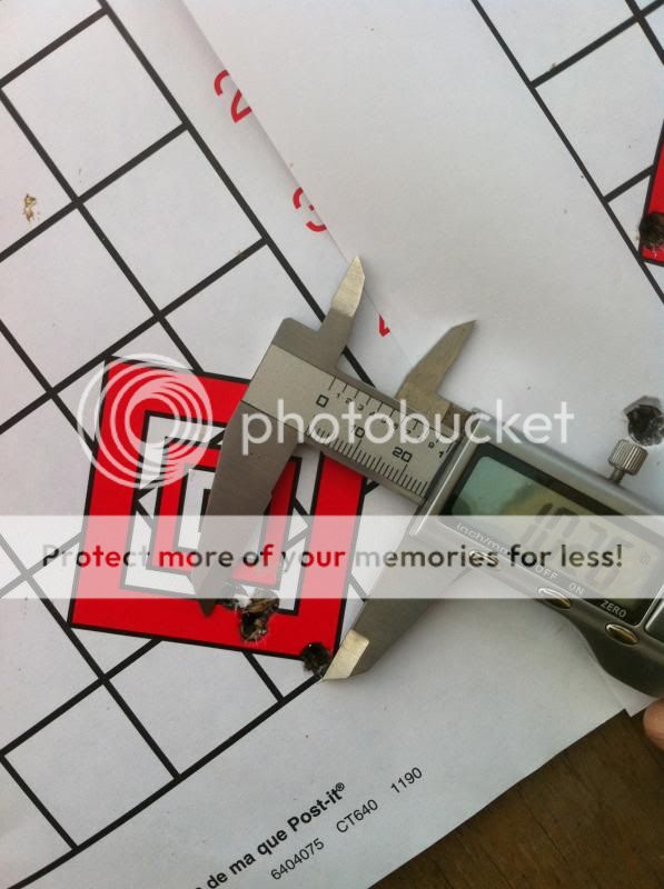

this was a 5 shot group with hornady 53gr superformance factory ammo, dropped the 3rd shot, before the stock and the trigger i was hard pressed to get 1" groups, let alone 4 so tight.

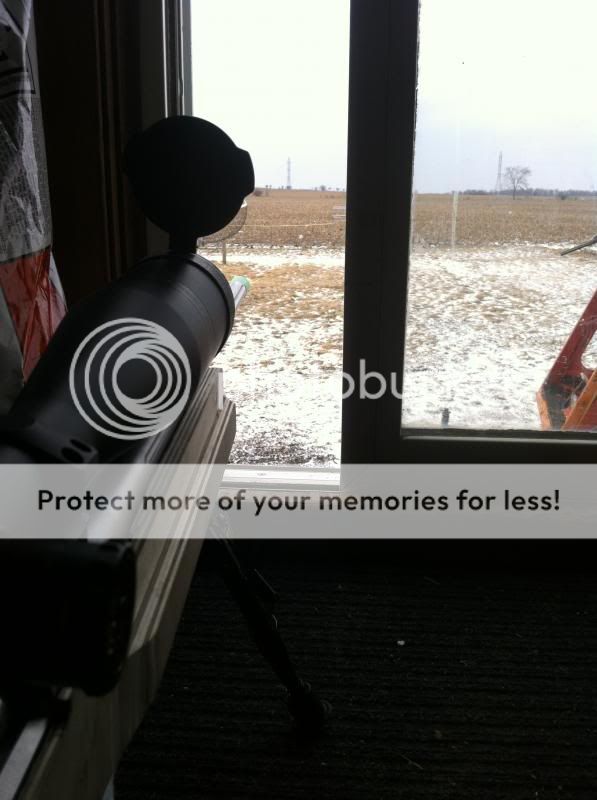

this is the sightron, the 2nd picture shows a hydro tower at 1300 yards away, the 3rd picture is the veiw from the scope.
