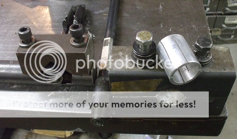

Not really, clamping in a vise doesn't usually give enough gripping power. For any action vise, a very easy set up is two 1" thick x 1.5" x 4" plates with bolts through them. If the bottom plate is 6" wide it can be bolted down to the bench. Tightening the bolts gives a much higher clamping force than a even the best bench vise. The only real difficult part for a guy with no decent tools or shop would be making the appropriate sized insert. I bore a 1.350" hole in a short piece of 2" x 2" aluminum then split it. Your local machine shop should be able to do that for you quickly and cheaply. 10" of 1"x1.5" stock cut at the 4" mark, and a piece of 2x2 aluminum bored to 1.350" can't be that expensive and will last you forever. Buy the barrel nut wrench, the SSS is better. Google brownells action vise for pics.

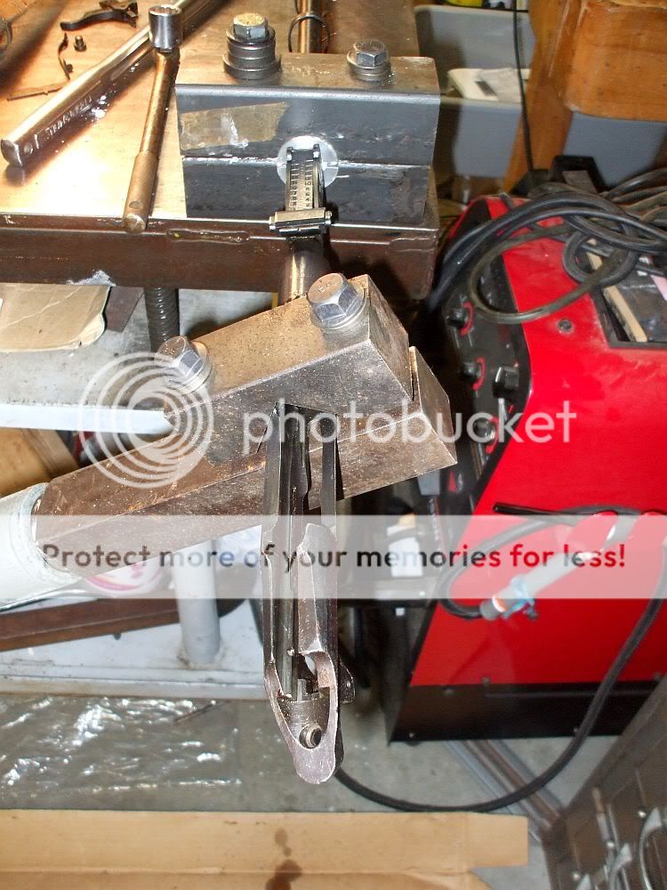

I have made a bunch of action wrench and barrel vise stuff. I usually start with 2"x2" steel bar. I have given up on 1/2-13 bolts for barrel vises, and now use heavier stuff, like 7/8-14.
I sometimes need 600 foot pounds of torque to get 70 year old barrels off military receivers.
I found squeezing a round action like a 700 onto the barrel threads makes it harder to remove... I much prefer the internal 'spade' wrench for round actions.
On military actions I found the shock of a hammer blow to be more effective than torque in breaking a barrel loose.

The pics Clark show are the basics. Instead of rounding out the vises I just left them flat and used square stock for inserts.

X2. Those advices are as good as they come. The two 7/8x14tpi bolts on barrel vise are an overkill IMO and so would be two 3/4x16tpi. My own barrel vises have two 5/8x18tpi 8 grade bolts with min 1 1/4" long thread to engage in to and if they are very, very tight then the chamber would be in danger of being squashed! I also use my own internal wrench b/c collection of external ones would be very, very expensive and marring the receivers would be the ever present danger....

Even so-so machinist is able to turn tapered bushing on the lathe, the secret is to use liberal amount of rosin or powdered sugar for slip free and marr free barrel change.

Barrel vise
If anyone is really interested in making one, locate a copy of the NRA "Gunsmithing Guide". It has a whole chapter on barrel work, and there are two different patterns of barrel vise in it.
Military actions are best held with a clamping wrench over the top of the action and across the recoil lug. The barrel held in a sturdy vise. Round actions like the Rem 700 can use an internal wrench.
