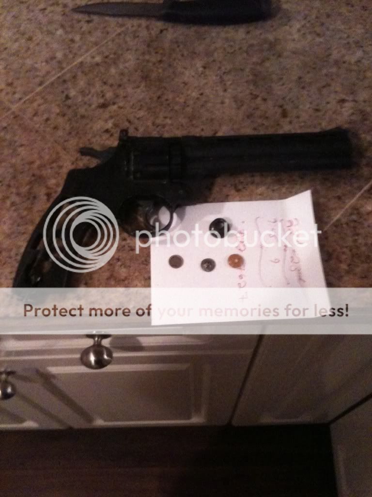

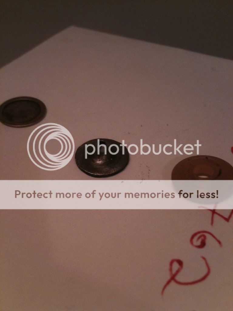

This is a Co2 piercing plate I made for a crossman 357 pellet gun I bought, because the factory breaker collapsed in on itself after a week. I used a grade 8 bolt for stock and first drilled a small hole dead center in the head, then chucked the bolt in a drill locked in my bench vise as a makeshift lathe and ground the piece to shape a steep peak around the hole with an angle grinder and files, then cut it off thin and polished it up. Works better than new and should last for years.
The piece in the center is the breaker and it sits behind the gas seal.
