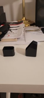

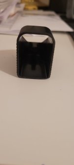

anybody that had to load the promag 597 mag know its a task for sure,i was looking for a mag loader that would work with the promag nothing available in canada well i did not find anything myself,but i started thinking i can make something myself,after a few trial and error i remember i still have the original glock mag loader that came with the pistol,long story short i remove 1 inch from the bottom and dremmel the little plastic part that push on the follower untill it fit inside a 597 mag and it works very well.

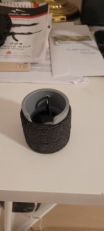

also i made a few other one that also works with a 1 1/4 electircal pipe,more work but will last forever,here is a few pictures if you have question dont hesitate.
