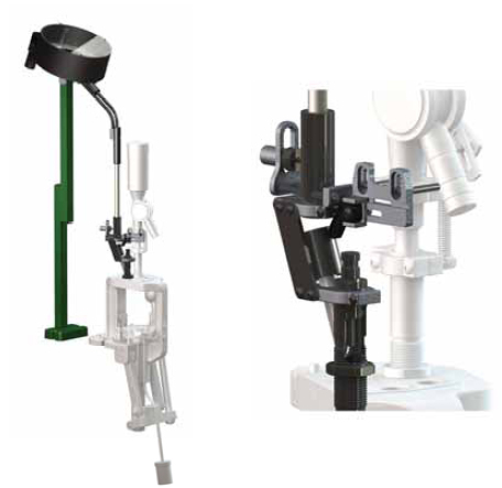

I think I am going to add one of these this Spring when I get my big bonus check at work.
RCBS bullet feeder.
http://ultimatereloader.com/?p=835
