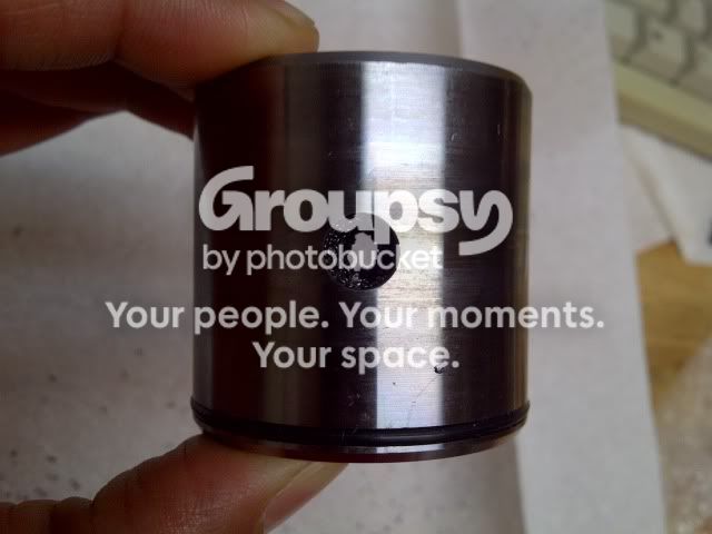

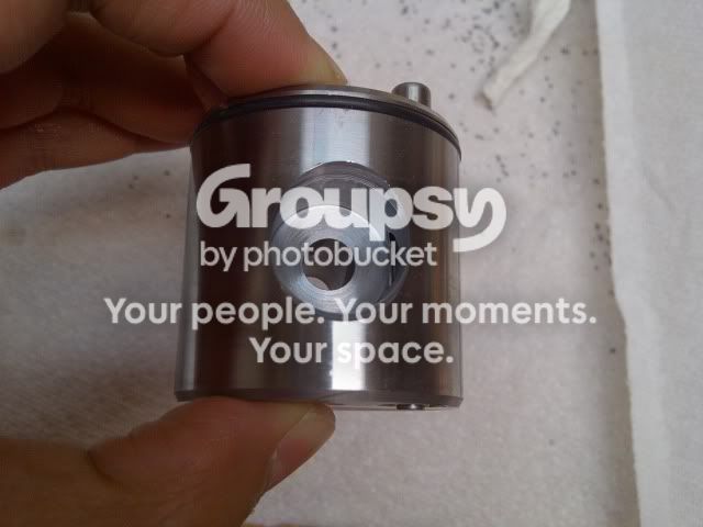

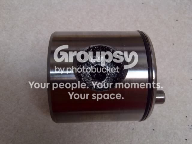

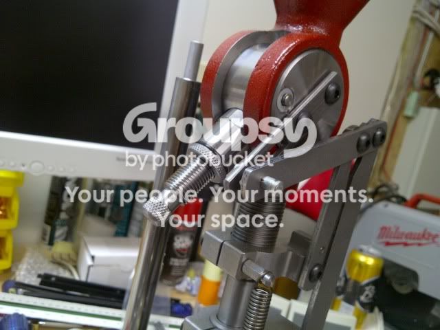

I will definitely look into picking that up. After taking out the current rotor, I noticed this:
Wow looks like a whole bunch of little magnets :)
I can't remember what I cleaned mine with but I only ever have a couple flakes in there, nothing like you have.
If you are constantly adjusting the insert for various loads, the moving action of the plunger can force flakes around the edges. This usually would happen if you were starting at a large charge volume and adjusting to a smaller volume (trying to compress the powder already in the rotor). The powder has to go somewhere and if not back in the hopper has only one other option. That would be in the void behind the plunger.
And from the picture you had TONS of powder behind the plunger (looked like 3-4 gr of titegroup...) which I hope was deposited in there by static as you removed the metering plunger assembly. If not Static, I would contact Hornady as it then would look like a tolerance issue with the rotor pocket and/or the metering plunger. The tolerance between the two should be tight enough to prevent any major amounts of flake powder from accumulating behind face of the plunger.

Personally I would bet that your rotor wasn't cleaned properly between conversion of 45 & 9mm. A blast of air may look clean, but there could still be oils on the rotor/plunger from your hands/cleaning cloth/etc...
I was emptying out the reservoir and the rotor to take pictures and after removing the insert and getting ready to slide out the rotor there was still some powder in the resevoir (i guess under the baffle) that poured into the back end of the rotor.
Also I keep a drier sheet inside the reservoir because it was really bad in regards to static electricity when I had first got the kit.
I just removed my small pistol rotor after having loaded 2000 of .45 ACP and 9mm and there were only 2 flakes stuck in it.
There is no way that what I saw in your picture is caused by static electricity.
I suggest you clean out your powder measure once again with either brake cleaner or 99% isopropyl alcohol and try again.
