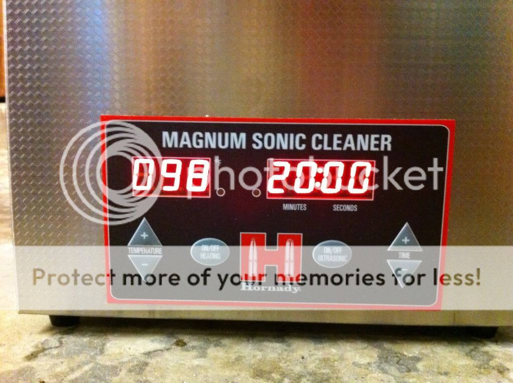

Now on to how the unit actually worked. I was quite impressed with the cleanliness of the brass. There are two settings on this unit, temperature and time, and from my first test I believe that the more heat used will reduce the time needed to achieve a desired clean.
Showing current fluid temp and set time, the little circles next to the displays light up blue when heat/ ultrasonic is on
