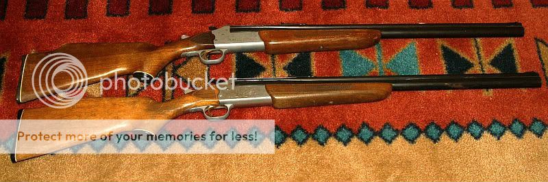

I have 1 that will a camper carbine 18" barrel 22/20 with an extra 24" 22/410 barrel set that is also very accurate but my other 22/20 won't and it has the longer 24 " barrel . Then again I might have just not found what works best in it.
The worst part of getting accurate with a 24 is taking the time to get use to the two finger trigger pull that most of the 24's have .
