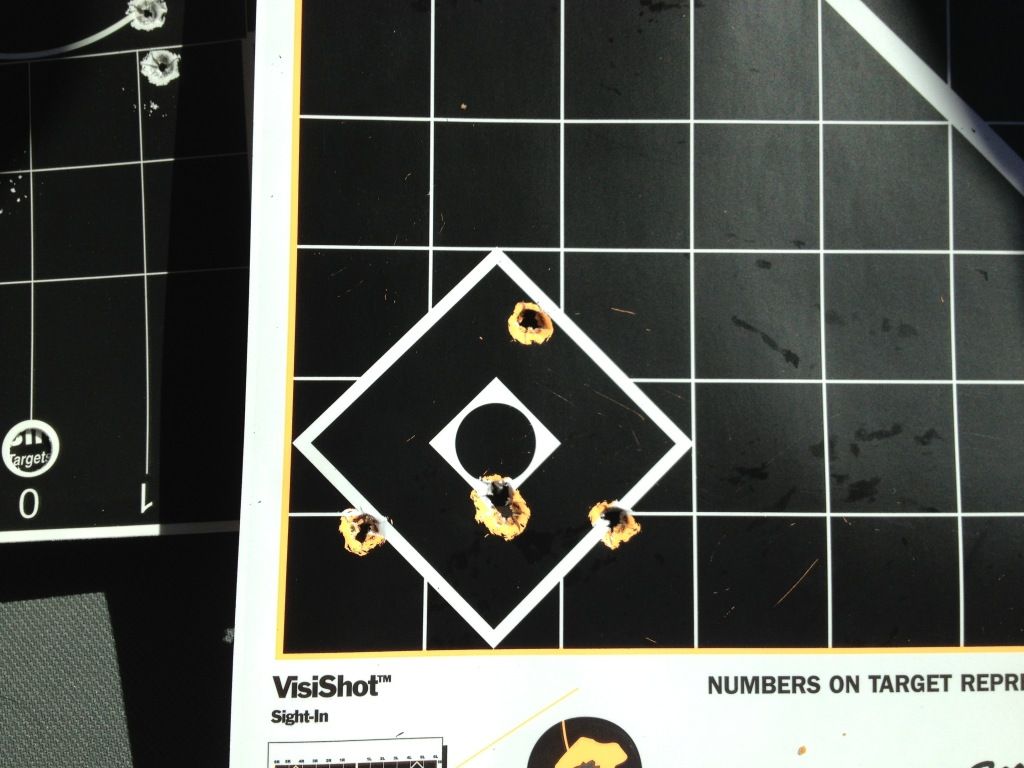

This is a bit of a different topic than the one I started about technique. Im wondering how much tighter I should expect to group my shots with my current setup. Maybe this is as good as can be expected or maybe others have better experience and I need to keep practicing (which ill do anyway). I was just hoping to get some opinions with actual pictures to go off of.
My setup is a Savage 10 PC .223, Minox ZA5 6-20X50 and im shooting Hornady 55g Vmax. Same ammo for every shot. I know the first thing everyone will say is "you need to reload". Im looking into it with a friend so we can split the cost of the press... but for now, ill be shooting the hornady ammo.
So, here are some shots of my groups from a few days ago. There was a mild cross wind, im always shooting down hill maybe 25 degrees at 200 yards (using a rangefinder). I try to give myself at least 30-45 seconds between shots. Most of the time its more and I never shoot from a hot barrel, only warm.
Group 1: The group to look at in this shot is the 3 in the middle (touching) and the one just to the left and the bottom right. Those were my 5 shots in a row. The rest were from sighting in before hand.

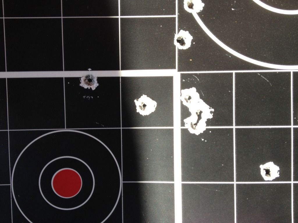

Group 2:

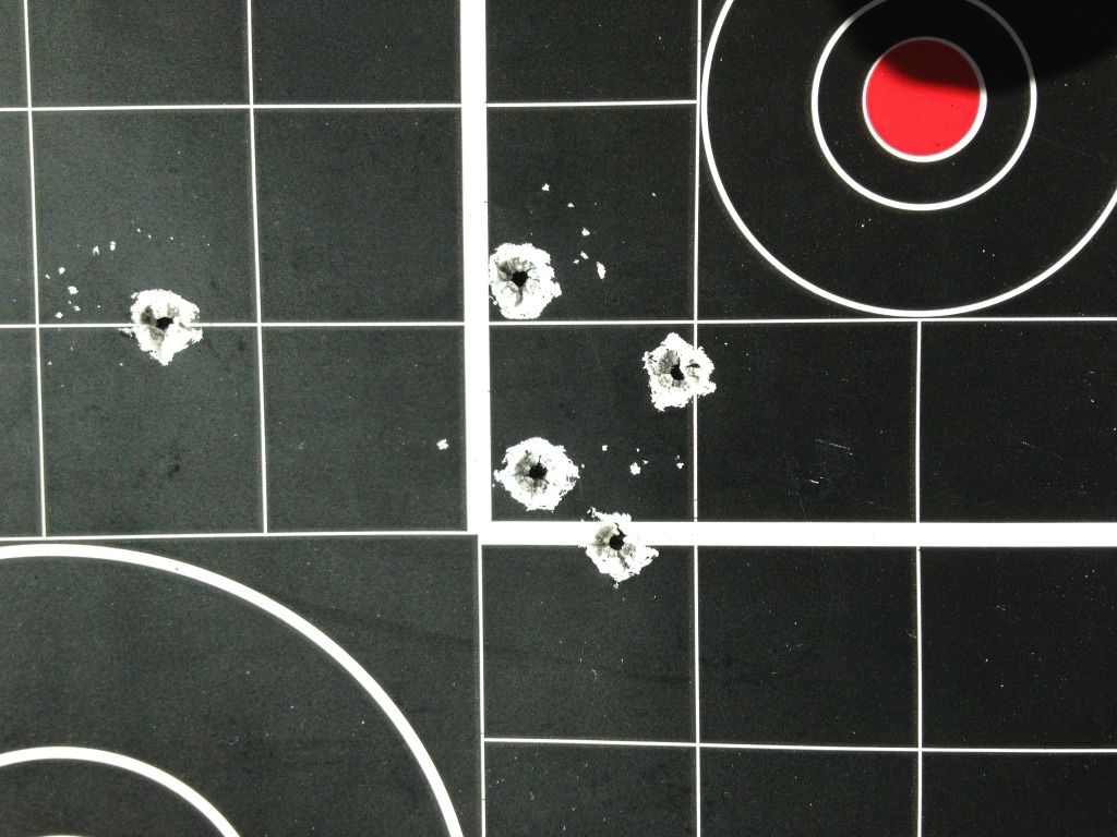

Group 3:
These were obviously my best of the day. I shot 40 rounds and used up 10 getting the scope sighted in as perfectly as I could, zeroed at 200 yards.

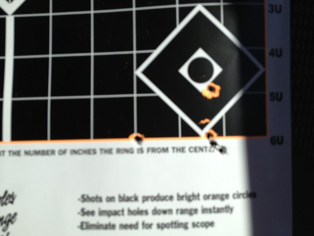

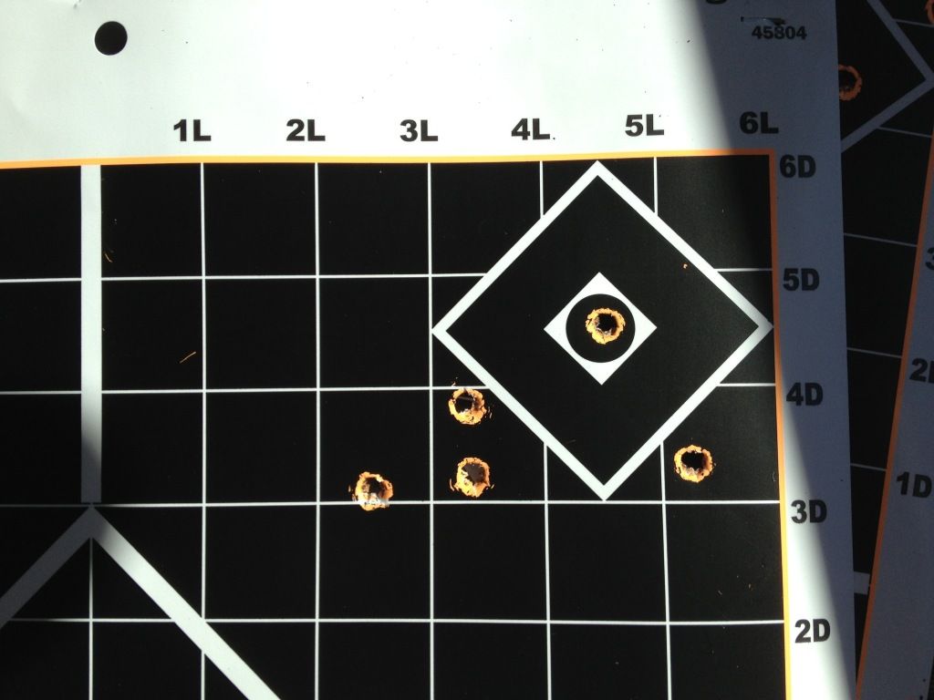

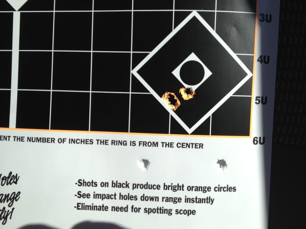

The next few groups are from a few days later. Little to no wind at all. Everything else stayed the same. Even the temps were similar.
Again I shot 40 rounds total... I used 5 to verify my settings then the rest I fired 5 at each target. All squares on all targets are 1inch X 1inch

You didn't mention what you're shooting off from. Bipod? Bags? A rest? Off a bench? Prone? Your shooting position and support will make a big difference in peoples responses.
I'd say from my limited experience - for using factory ammo you're not doing bad. You've got some flyers that break the group apart and you should figure out why those are happening. Are you pulling your last shot from fatigue or a bad wind call? Try experimenting with different positions and find out what works and what makes things worse.
With my own shooting I've found that my shot-to-shot consistency is good, but my session-to-session consistency is bad. I'm not getting into the same position behind the rifle every time. This causes a lot of inconsistency if the point of impact and my comfort behind the rifle.
When shooting groups waiting too long between shots can also cause them to open up due to the changing conditions. Once you've got your fundamentals down and you've got a steady scope picture at your natural point of aim - take the shot. Wind changes quickly. Take the shot as soon as you have confidence and don't second guess your call. You're practicing - you can evaluate the results of the shot after taking it and apply what you learned on the next one.
Once your groups start to get reasonably tight, start looking at the overall shape. Generally speaking, a vertically oriented group can indicate inconsistent velocity – something you won’t be able to control until you start handloading. Horizontal groups can show where your technique needs work. I.e. inconsistent trigger press, follow-thru, grip pressure, body position etc.
