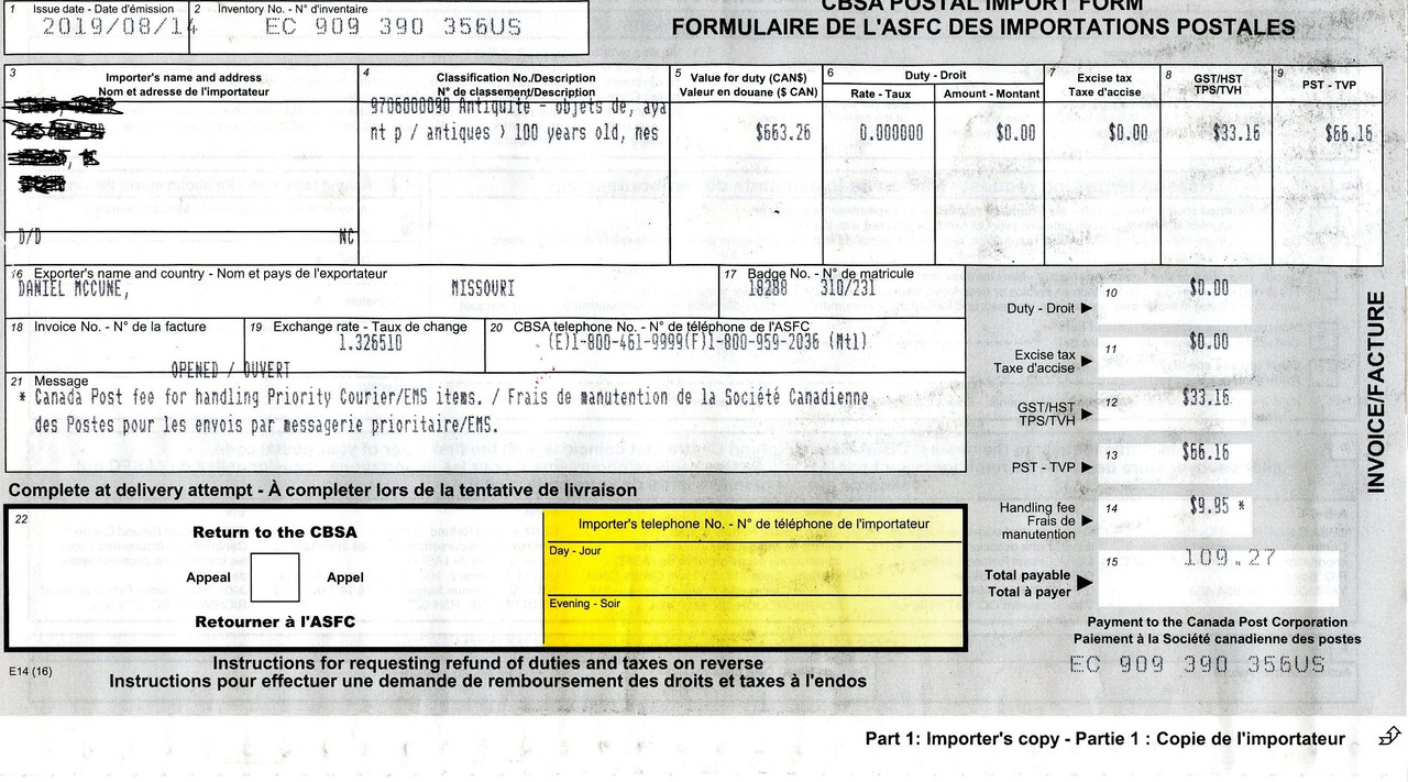

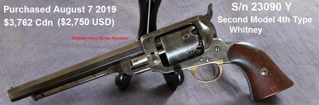

I bought this Whitney revolver from Ancestry Guns in Missouri in August 2019.
I paid taxes at the post office. (See below)

How is declared value $663 while the paid for value on your picture is $3762 CAD? I thought there are no personal exemptions for shipped items
