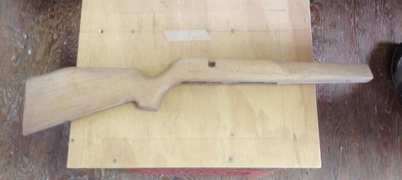

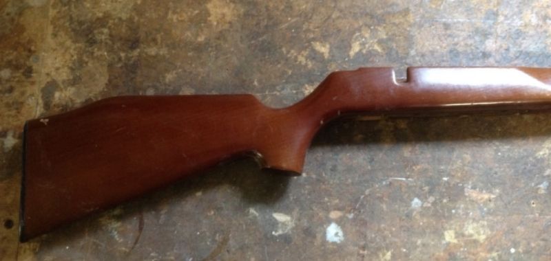

I stripped the old finish from the stock and got down to bare wood. I sanded the stock and since I had a variety Min Wax stain on hand, I thought I'd see what it looks like with a light translucent stain and Tru Oil.
First, here's what the stock looked like with the original finish.
With the original finish removed, the plain beech, which is very light, is revealed.
The pictures don't really show the grain as they were taken with a phone camera, unlike the others.

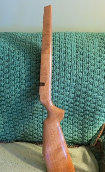

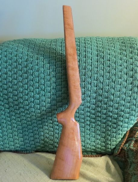

I applied Min Wax Golden Oak stain. I checked out some solid stains, but they seem little different than paint.
Of course, if the right colour is found, there's no problem with that.
I have four coats of Tru Oil on it in these photos and I will put on a few more.
I have ordered some wood dye. I think that if I find I'm not satisfied with the stain and Tru Oil finish, I'll experiment with the dye.
There are two different ways to apply the dye. One is to mix it to the colour desired and apply it to the bare wood, followed by a clear top coat, such as Tru Oil, poly, or lacquer.
The other way is to mix the dye with the top coat and then apply it to the stock. Each successive coat should make it a little darker and this will conceal the grain more with each coat.

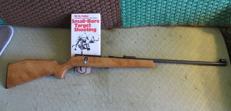

Here's the barreled action in the stock. I haven't decided yet whether I am satisfied with the refinish.
Nevertheless, I'm looking forward to shooting this new-to-me rifle.
