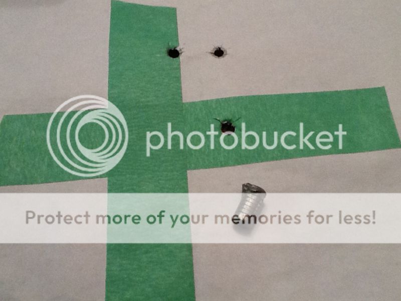

Here's what a 285 gr cast from wheelweight metal looks like after passing through six 4 litre jugs of water, and getting caught in the seventh.
9.3X62, started out a over 2200 fps.

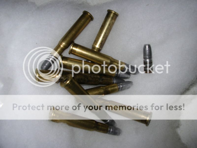

Here's a few of my 30-30 Long Rifle loads. :)
I call them that because they get 1335-1355 fps velocity with a 180 gr cast bullet. The same velocity as the 22 LR, but with a bullet that weighs four times as much.
Have not used them on any big game yet, but have no doubt they would be fine. They easily penetrates 8" of green spruce.
Ted
