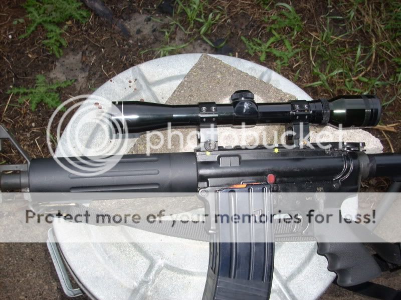

Howdy guys,
I'm about to order some stuff for my AR and I want to make sure it'll work before I pull the trigger and order it all.
I just ordered a new fore end and my AR will look like This
Basically an M4 style AR with flat top rails but it still has the front tower sight.
I plan on mounting this scope on my AR.
Here's my issue, I'm having a hard time finding canadian retailers that carry an easy way to mount this on my rifle which will be high enough to clear my front sight.
If somebody could show me how they would go about mounting this scope that would be a great help.
Thanks
