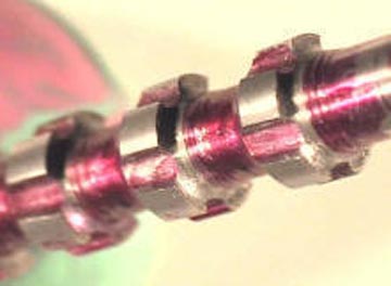

SDC said:The second most common is called button rifling, which uses a mirror image of the rifling cut into a piece of very hard metal like tungsten carbide; that button is screwed into a rod which is pulled through the barrel blank under tremendous hydraulic pressure, leaving the land-and-groove pattern.
SDC said:Here's a picture of a TRUE button, but it's harder to see the lands and grooves in it:
