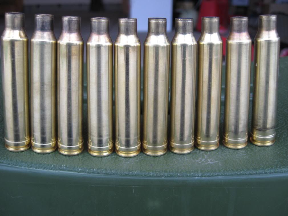

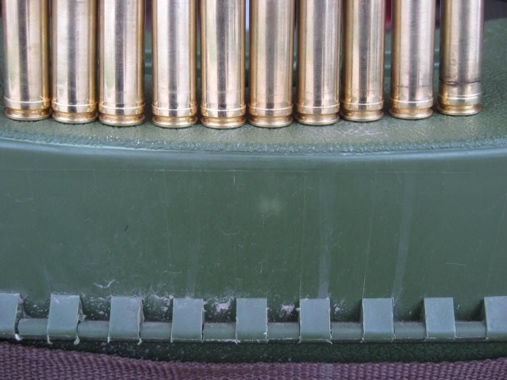

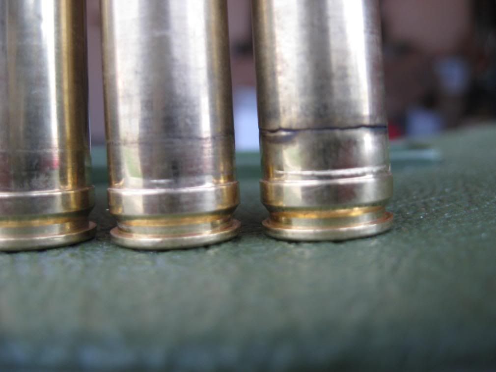

300 win mag brass. Signs of impending failure. Look for the light coloured ring going around the case. Obviously, they are lined up from left to right, best being on the left.
I was getting around 13 firings out of my brass under full pop loads. I have some that I've fired in excess of 20 times shooting reduced loads with cast bullets. Typically, I'll fire them all 5 or 6 times just neck sizing, then I'll have to full length size again, then get another 5 or 6. Some will take another full length size, and some won't. Always inspect your brass before reloading. I have a tool that I specifically keep for removing brass from the chamber in this gun if I get a head separation. It still isn't fun getting it out, so I try no to push it over the limit. Since these pics were taken, I've changed the barrel and tightened up the headspace. We'll see how it goes from here.
