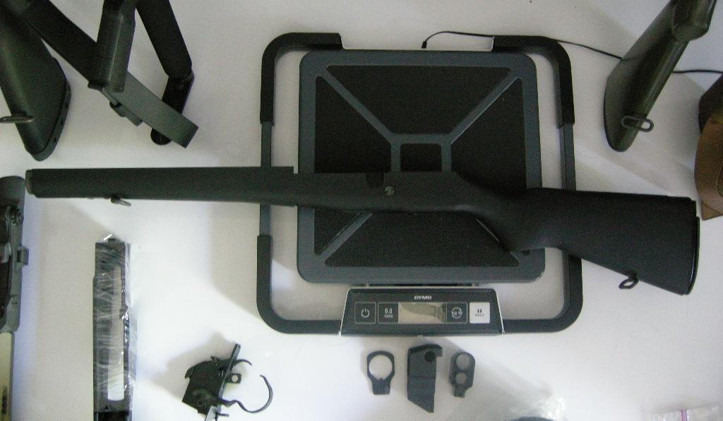

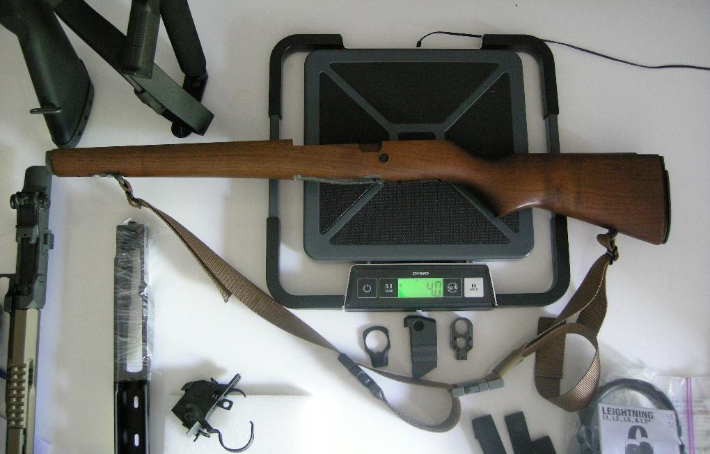

Different said:
Here are the weight results for some stocks I've weighed (metal hardware included):
stock assembly, fiberglass USGI 11686428 46.2 oz (2.8875 lbs.)
stock assembly, fiberglass USGI 11686428 49.0 oz (3.0625 lbs.)
stock assembly, fiberglass USGI 11686428 45.4 oz (2.8375 lbs.)
stock assembly, walnut USGI 7790702 41.8 oz (2.6125 lbs.)
stock assembly, walnut USGI 7790702 44.4 oz (2.775 lbs.)
2336USMC said:
USGI wood stocks vary quite a bit in weight, due to the density of the individual wood blanks. If you want a light one, you might try taking a postal scale to a gunshow or someplace where there are a number of stocks to pick from.
Here are some stocks I have weighed, notice that some of the standard "skinny" stocks weigh as much as a Big Red, and that the GI fiberglass weighs more than some of the wood stocks...
Stocks, no buttplate or rear swivel
USGI walnut #1 34.3 oz Tru-oil
USGI walnut #2 33.7 oz finish stripped
USGI walnut #3 33.7 oz spray camo, glass bedded
USGI walnut #4 39.1 oz, oil finish
USGI NM birch, medium hvy dwg # 11010263, Sykes, routed for bedding 34.9 oz oil finish
USGI NM walnut, medium hvy dwg # 11010263, S.A., glass bedded 36.5 oz oil finish
USGI NM mystery wood, heavy contour dwg #9352638, Fajen 33.9 oz no finish
USGI NM walnut, heavy contour dwg #9352638, Fajen 41.4 oz no finish
USGI fiberglass 36.9 oz mil finish
USGI fiberglass #2 40.8 oz spray can camo
Hueygunner composite stock 37.4 oz green CARC finish
USGI M14 buttplate 8.2 oz with screws, 7.4 oz 210 gm w/o screws
USGI M1 buttplate 3.8 oz 109gm w/o screws
Rubber spacer 7790914 0.8 oz 22gm
USGI front ferrule 6g
USGI front sling swivel, no rivets 22g
USGI rear sling swivel 22g .8 oz
GI1
McMillan fiberglass stock: Approx. 4 lbs. (Need reference) Approx. 4.5 lbs with buttplate and screws.

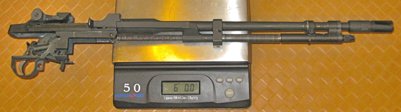

Barrelled Actions:
Standard barrelled action with a GI barrel, handguard and trigger group to weigh approximately 6.1 lbs.
If someone can confirm this, please do so.

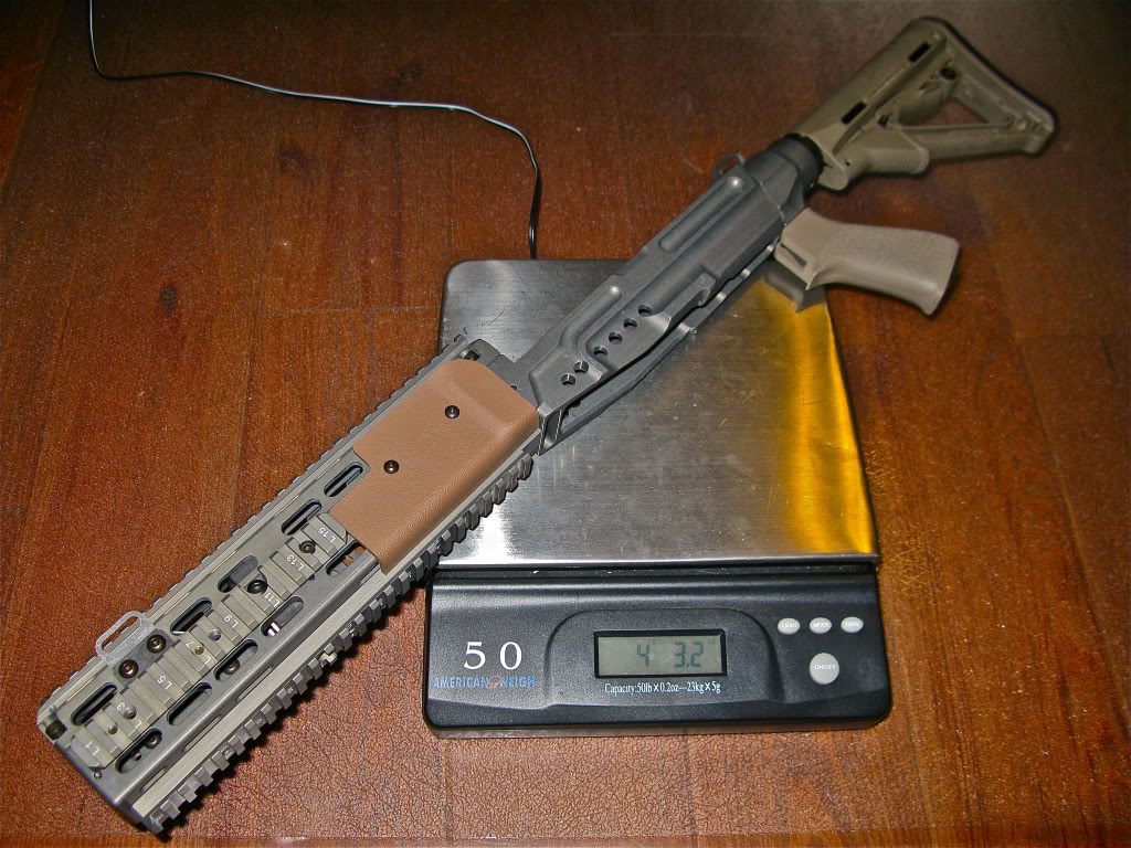

Weight as pictured
Crazy Horse M21A5 EBR: 12 lb 14.2 oz.
Blackfeather CQB-16: 12 lb. 7.0 oz.
optic, rings & spacer alone: 2 lb. 6.8 oz.
