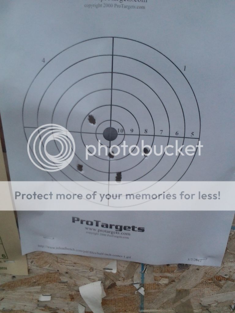

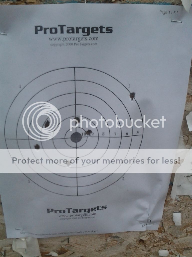

Here's the groups I've been getting. I'm gonna try different factory loads tomorrow if I can get to a shop before closing time.
Just so you know, I have a Savage 12 BVSS that shoots 1/3 moa and has had better groups, but shoots win white box, 4 shots 3.5+ inches. I am using the remainder for fowlers. So I don't think its the guns fault. Cheers Roscoe

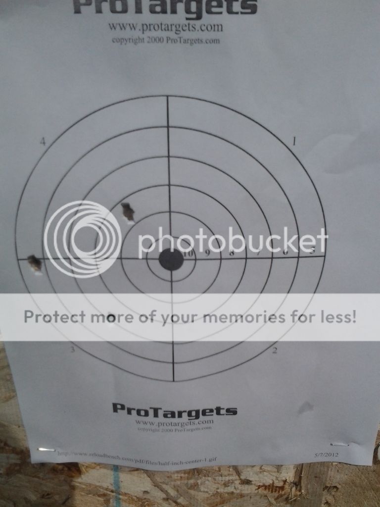

Fired 3 rounds of white box 55grain FMJ to start and got this

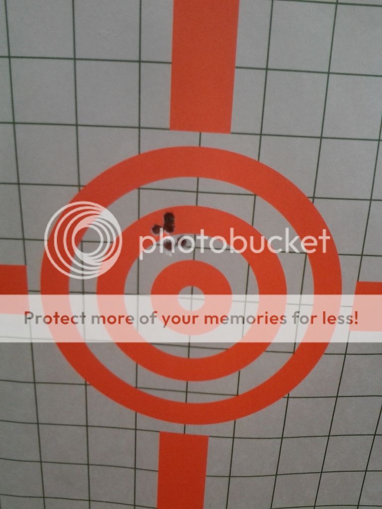

Then fired 5 rounds of hornady
Even in my shaky frustrated hands I managed a 3/4 inch group! I feel so relieved now that its working right!
