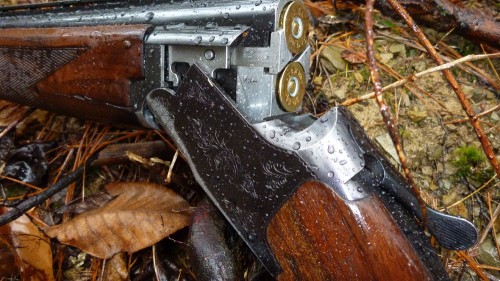

  • Is anyone else taking their O/U and SxS out hunting in inclement weather?
  • How often do you take them apart for a clean and lube job?
Personally, I kind of like to go out hunting on rainy days, just I kind of like going out hunting when it snowing outside... Sure, I also like going out hunting with it's sunny... or cloudy... and cool days are fun... and warmer days are still enjoyable... but that's beside the point.
The shotguns will get a complete strip and clean job at least once a year, and after any days spent in the rain.
- If I had to take them down to a smith to have them cleaned, I'd probably be broke by now.
I also hunt with my SxS in inclement weather. I clean my gun after every hunt.
If it got wet (not that often) or it was cold out and moisture condenses on it, I do two things. I make sure I keep it out of cases as much as possible. Ie only when traveling. And the moment I am in for the night, wherever that may be, I place the gun near (not on) a heat source. I want all the metal to warm to well above room temp. Warm to the touch. But not hot. Kept warm, whatever moisture may have found its way into nooks, crannies and the action will find its way out. Once warm and dry I give the gun a wipe with my oily gun rag.

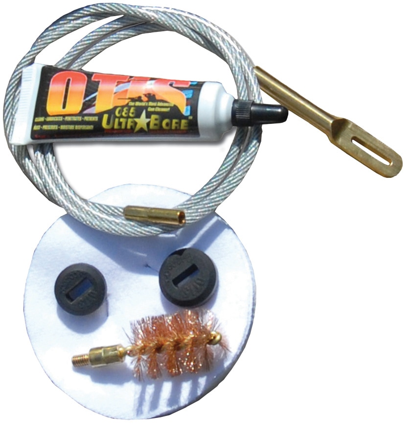

Speaking of cleaning... A number of years ago I kind of bought one of those Otis cleaning pull-through shenanigan (it had a broken latch, and was in the discount bin for really not much $). I figured it could come handy as a leave-it-in-the-truck kind of thing.
Next thing you know, I really kind of like it!
- OK, I'm not a high volume shooter... After an average hunting days, I only have to wipe-out the powder residue from a handful of shots... but still, I really like how good of a job that rubbery thing does.
