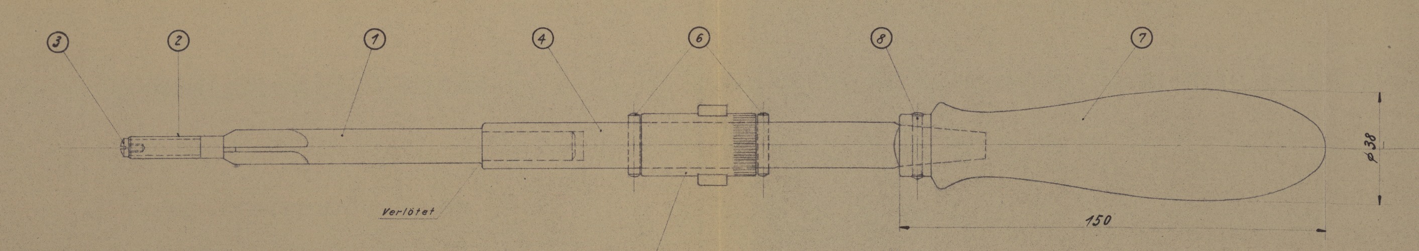

On both the IG11-Kar. 11 and Kar. 31, after the barrel is clocked in place via alignment of the reference marks, the headspace is adjusted by a combination of the correct bolt head length (available in 0, +0.05mm, +0.10mm and +0.15mm), and lengthening the chamber via a special hand reamer (as shown below).
