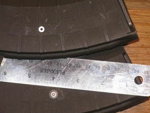

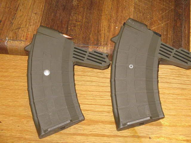

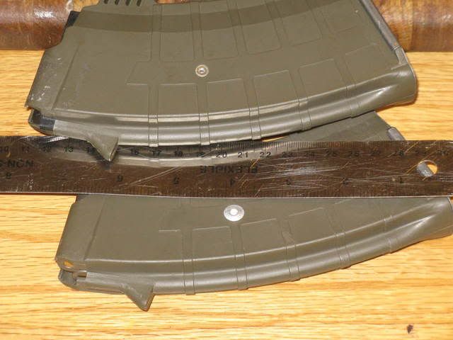

Hi does anyone have a tapco 20 round sks mag blocked to 5? How was it done and can you post a couple of pics? Specifically where does one place the rivet or whatever? Thanks in advance.
I have a couple.
I'll dig em up and take a picture with a ruler.
The rivet was placed on one side a couple of inches down. It means you cannot remove the follower or spring.
Sorry it took so long it was my birthday on the 19th and I ended up in my cups.
Heres two differently pinned mags. The one on the right is pinned to high and it only holds 4. The one on the left with the raised rivet holds the proper 5.
This should go to show you that it's a fine line. The two rivets are different types. I think I'm going to try to fix the one that doesn't hold enough. I'm going to Can tire to look at rivets this week.
