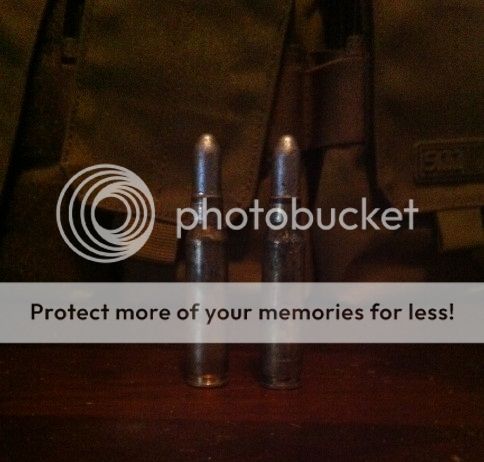

I am using a 200gr RNFP projectile made from range scrap and gas checked with hornady .30 cal GCs
I use a Lee universal neck expander to open the necks just slightly on my cases before seating projectiles to avoid the neck shearing the bullet. I setup my RCBS seating/crimp die so that the neck lines up perfectly with the crimp groove and it just give enough crimp to stop the bullet from moving around. I can't move the projectile forward,back,left,right... but i can rotate it.
The projectiles are lubed with Lee liquid alox and sized to .309 with a lee sizing die. I found it to be the quickest and most cost effective way to set them up.

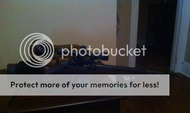

The rifle I'm working with is a 2012 Shorty Norinco M305. Its in a USGI stock with USGI flash hider, USGI handguard, and NEA oprod spring guide. The gas system locks up tight and the handguard doesn't move at all. The only problem with this rifle is an over indexed barrel but since im using a scope its not a big concern. Scope is a Bushnell 10x40 Elite tactical on a Gen 1 SA scope mount.
Although I haven't completely ironed out my recipe. I have had very good results with the following.
200gr RNFP W/ Gas Check
OAL 2.6"
29.0gr of IMR 4064
Winchester Large rifle primer

This recipe will cycle the action perfectly on my shorty depositing the brass in a nice pile about 2 feet away. the only problem with it is the bolt stop won't engage after emptying the magazine. (it will engage on a full length barrel)
