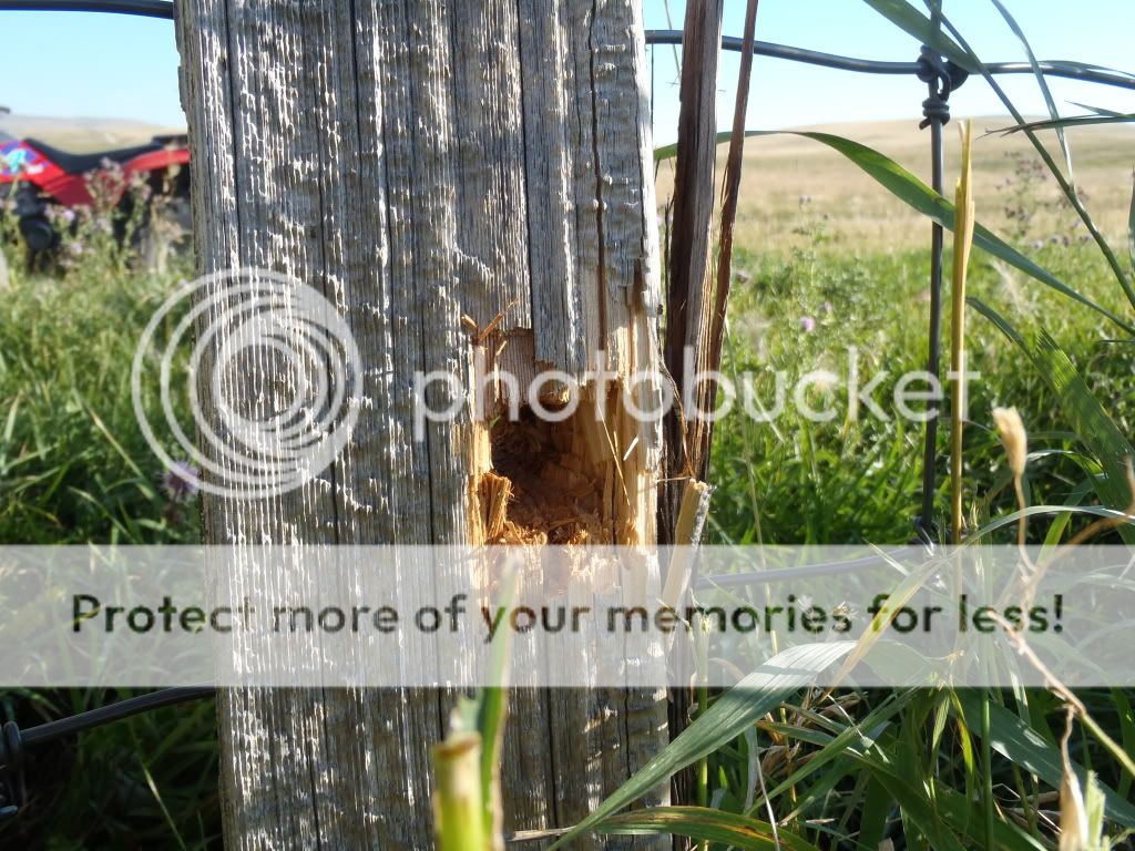

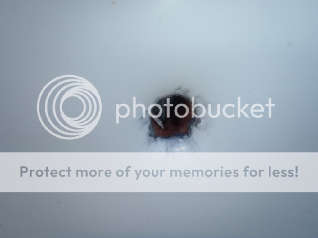

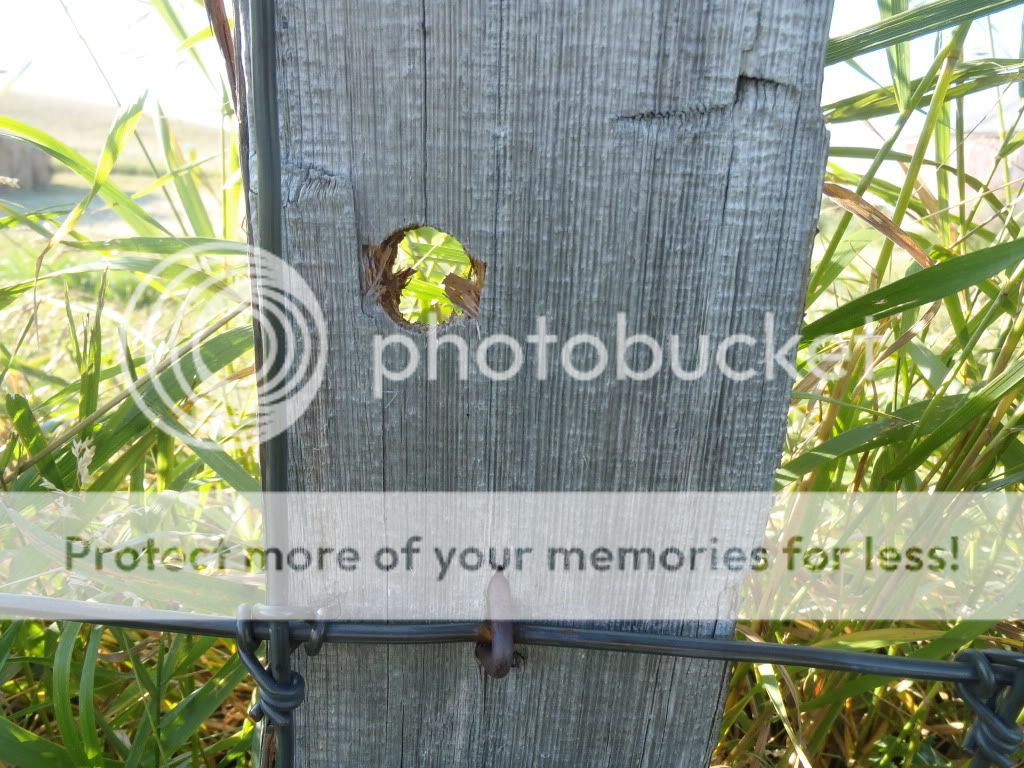

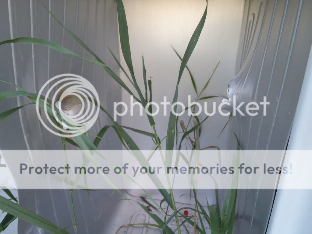

I gave her a try today in the old single shot 20guage savage. Used winchester trap loads of 7.5 shot. Took a few tries to get the cut in the right place, my first three attempts just splattered shot against an old fridge. Attempt #4 I cut higher up right where I could see the shot and it worked like a charm, punched right through a 20 year old fridge and made a mess of the inside. Next shot went as deep as my pinkie finger into an old log. For my last attempt I tried to find a gopher but had no luck (too late in the year) so I tried to hit a old cedar fence post from 40yards, damn near broke the post in half, perfect hole in the front and a massive exit wound on the backside, post was about 3 inches thick.

The fridge
Through he freezer
Only a splatter left for the bottom

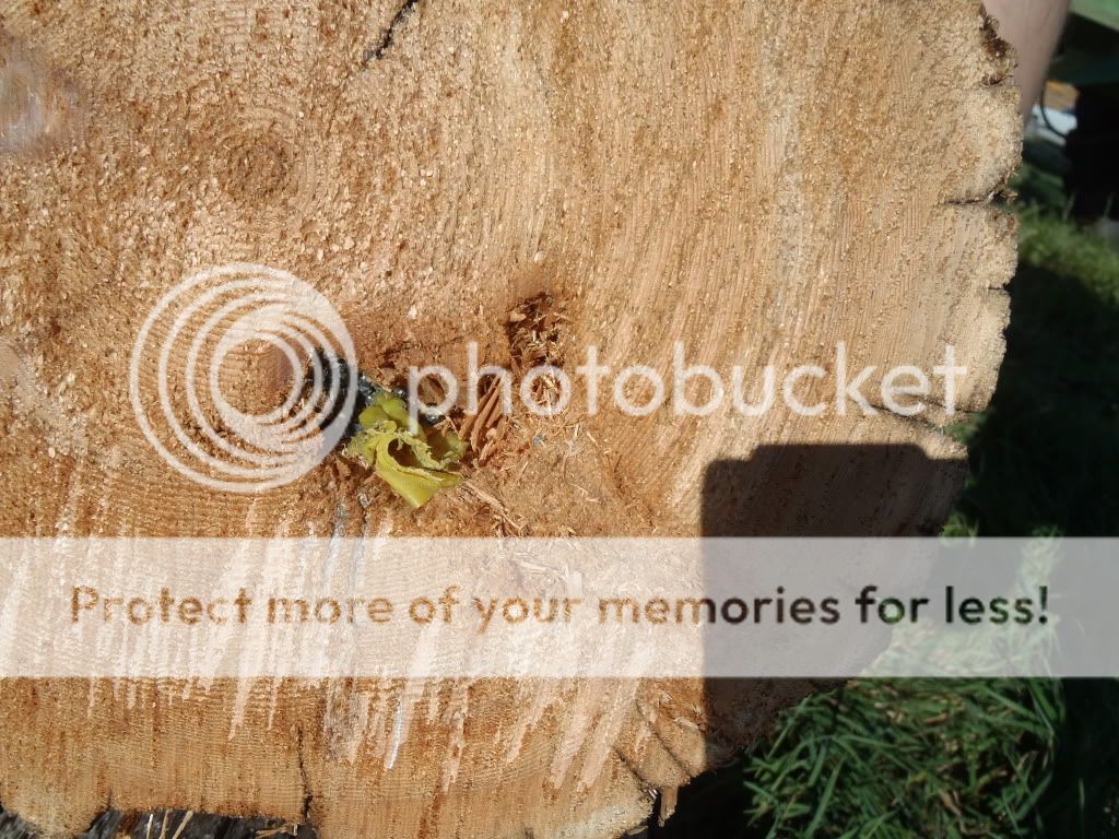

Old log

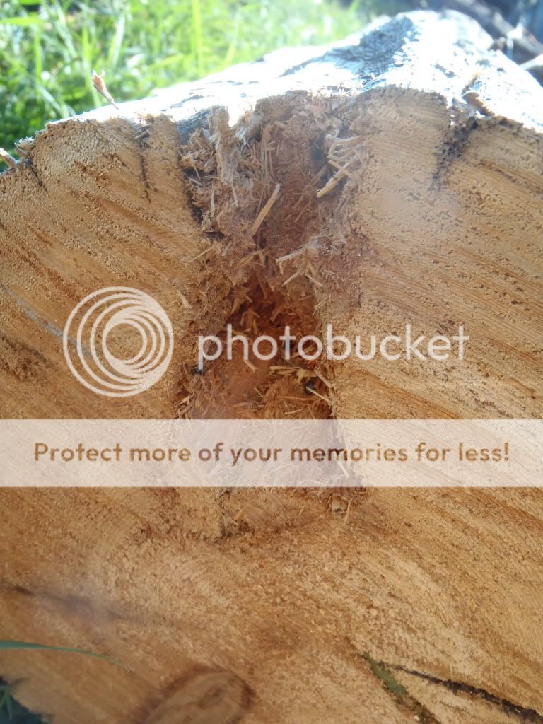

Chainsaw autopsy
about 3" deep

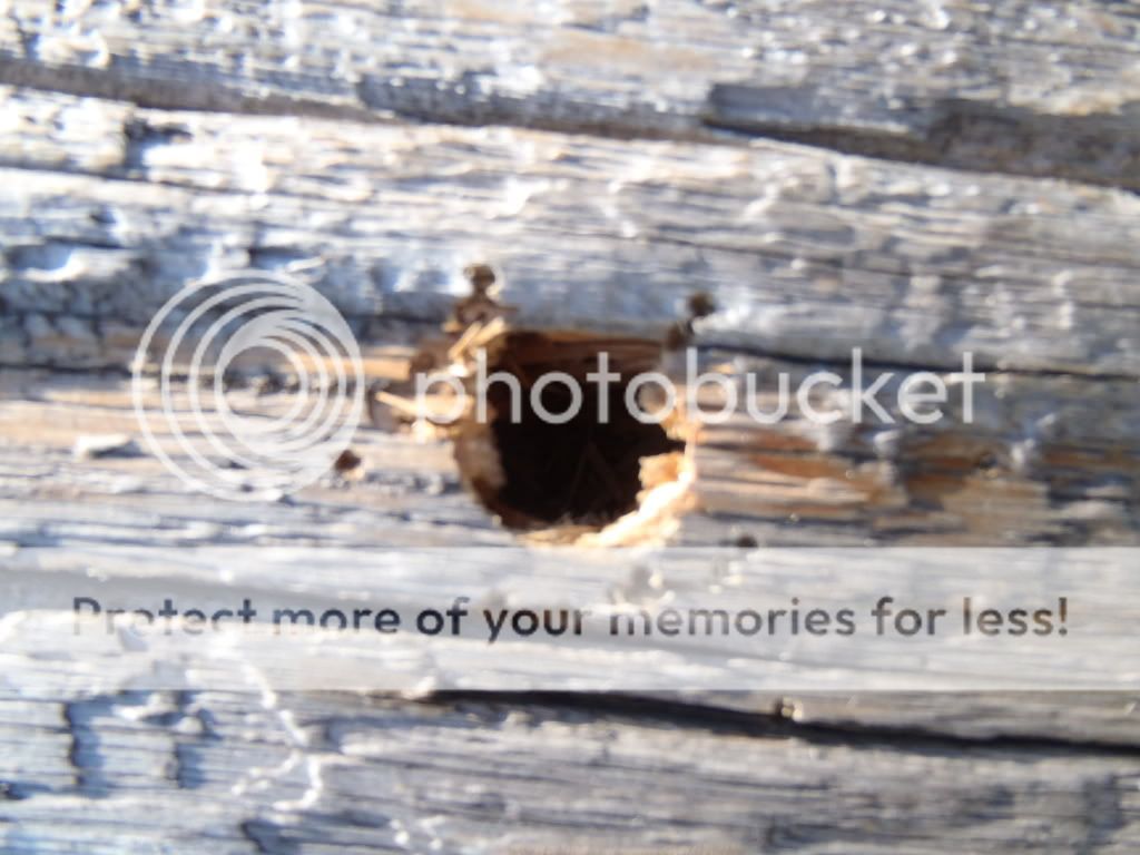

Old cedar post
yeah I was impressed as well, especially since it was from 30 yards away!
