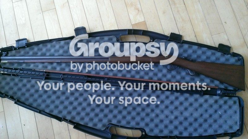

Hi,

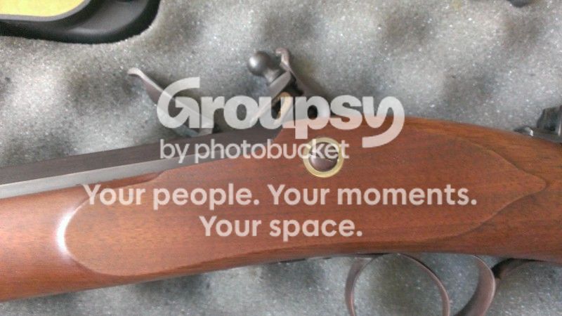

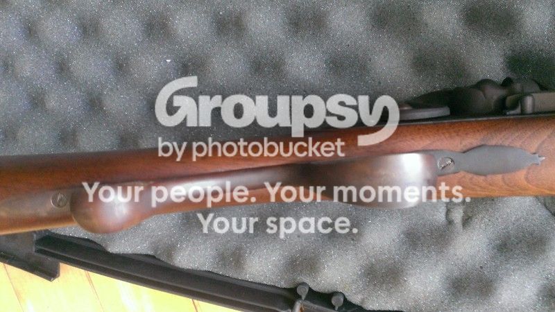

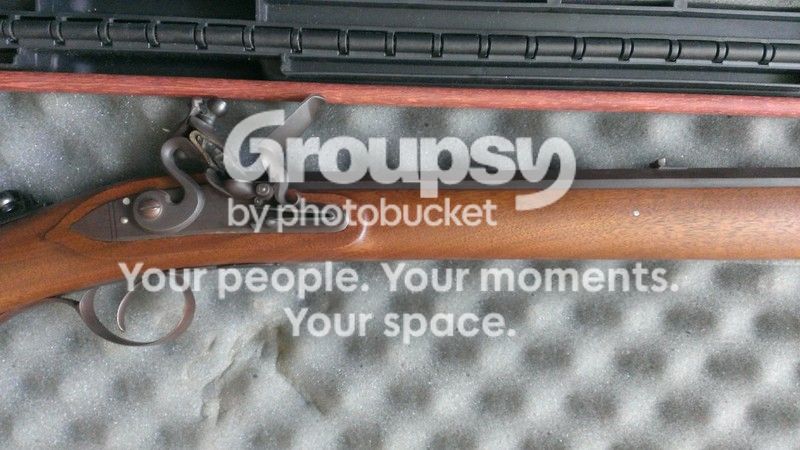

i want to know the barrel maker of the custom build blackpowder rifle i have and tried to disassemble the rifle to get a look, but i cant find how to do it... I am not used to this kind of rifle:
I removed 2 screws at the trigger guard
the side screw:
and not sure what to do next...

The small silvery pins below the barrel would need to come out.
The chance of buggering the wood is high so you really don't want to try without very good reason. It's not too likely to have much info anyway as the barrel was likely finished by whoever made the gun and would have put any markings in plain sight.

The small pin that passes through the fore end beneath the barrel holds it in the stock, along with the tang bolt. You also must remove the ramrod and the crossbolt that holds the lock in place as they otherwise can interfere with removal of the barrel. Even though the rifle may be a "Custom-made" gun, if the barrel is from a commercial maker then it will definitely be stamped with the name and rifling twist rate and likely that will be found on the bottom barrel flat at the breech. That little retaining pin should slide out quite easily if nudged with a slightly undersize pin punch.
