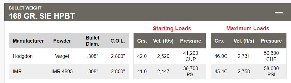

I want to find the most accurate load for my 308. I purchased 100 Hornady Amax 168gr and 100 SMK 168gr. I have 2 powders Varget and IMR 4985.
The gun range I go to is like 1.5 hour drive from my home so I would like to test as much as possible when I'm there.
I was thinking I could load 50 bullets of each brand using Varget and 50 of each using IMR 4985. Doing 5 increments of powder every 0.5gr. 2 groups of 5 shots per increment.
I thought that shooting 2 groups of 5 will give me a better average since a "lucky small group" can deceive you into choosing a load that might not be very consistent when you shoot more groups.
I would be loading using Winchester once fired brass in my bolt action, neck sized only and CCI primers. OAL 2.800".

After shooting all this I could probably get a good idea of what my rifle likes the most.
I know most people use only Varget but I read some people had really good results with IMR 4895 and I have several pounds of it so i thought I could test it also.
Do you guys think this would be a good way of testing? Or should I just ignore the IMR 4895 and do more grain intervals with Varget?
Let me know what you think!
Many thanks!
