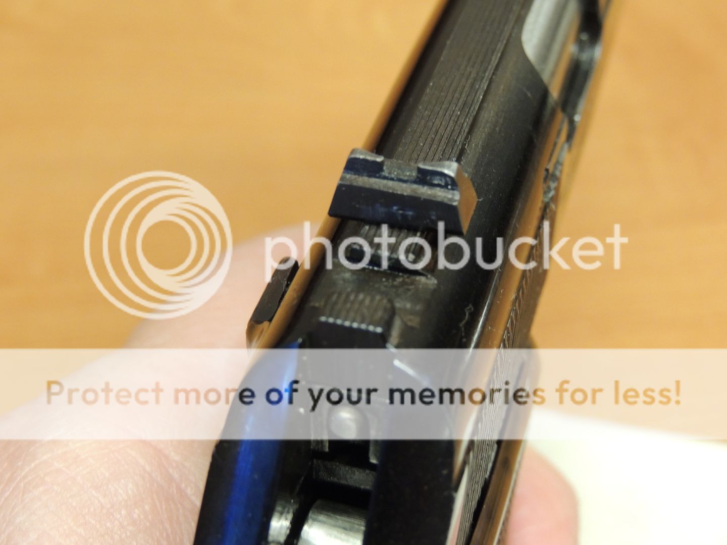

I have an Astra Constable.
The rear fixed sight sits in a dovetail on the top of the slide. It came loose the first time I fire it. It is tapered and designed to enter the dovetail from the left side (safety/release side).
The sight base itself is tapered.
How do I tighten the fit in the dovetail. I have read that you can use a punch but would like some advice from you Nutz on how to do this.

When I get home, I'll look through my box of PP/PPK parts for a proper rear sight. That one sure looks wide.
