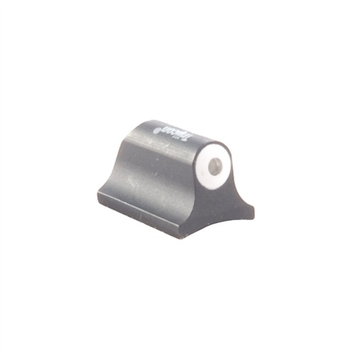

I'm thinking I don't need to move it up much... Would something like this raise it to at least get it close:

This might be what I'm aiming for... Simple and elegant solution.
