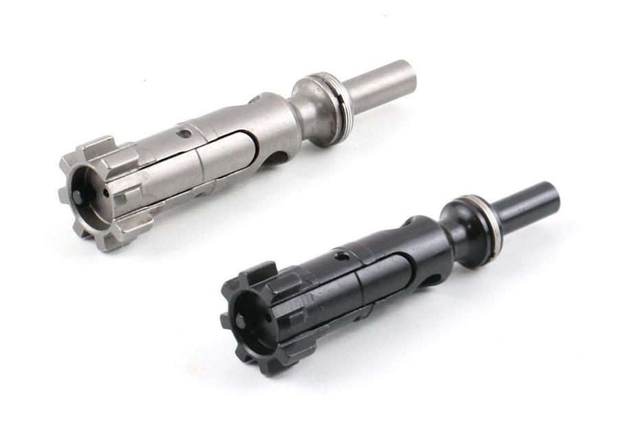

###y bolt pic. The one on the left is nickel-boron. we have this option for most sizes at the time of writing this. Click the pic for the product
