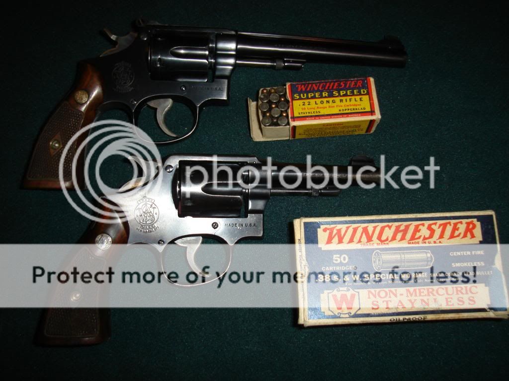

photobucket is pretty messed lately but here's a couple
pre-model 10 4-screw. the one on the right
The bottom revolver is a K-frame, pre-model, long action, serial begins with S

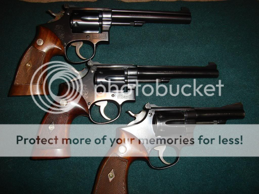

Here's a new one I bought in 1975-76 . . Still have it.
What prefix letter C or K in front of serial # Could be Model 10 or Model 14 Or Model 15 give us the Serial 123XX and we will tell you what you have..
The sights would tell you that.
If it has a fixed rear sight, it's a Model 10/Military & Police. If it has a click adjustable rear sight and Partridge front sight, it's a Model 14/Target Masterpiece. If it has a click adjustable rear sight and a Baughman Quick Draw front sight, it's a Model 15/Combat Masterpiece.
