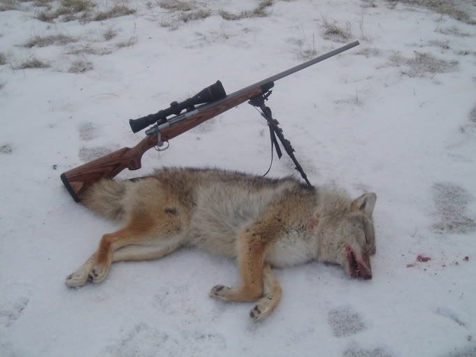

Here is what I envision as the perfect coyote rifle.
Rem 700
Fluted King 24" 1:14 twist Rem Sporter Contour
Rem 700 Lam Mtn stock
I had it built to replace my 22-250, and it is doing a great job. It is a tack driver (3 1/8" groups at 450yds) and is downright fun to shoot.
It allows me to shoot very economically for practice, yet delivers all the smack I desire for bustin' dogs.
It mimics my 280AI for weight and balance, so is great for practice, it is steady off of the bench, yet light enough for plenty of offhand practice.
I bought 1000rds of brass for it, and once they are all fireformed, will shoot them (~20 times) without trimming them... and then trash the whole lot. That equates to about 20,000 rounds.... looking forward to it.
An affordable way to do it would be to pick up a Rem LVSF in 223 Rem and have it punched out to 223AI... and then down the road stock options are yours...either keep the LVSF stock or throw it in a Lam Mtn handle.
