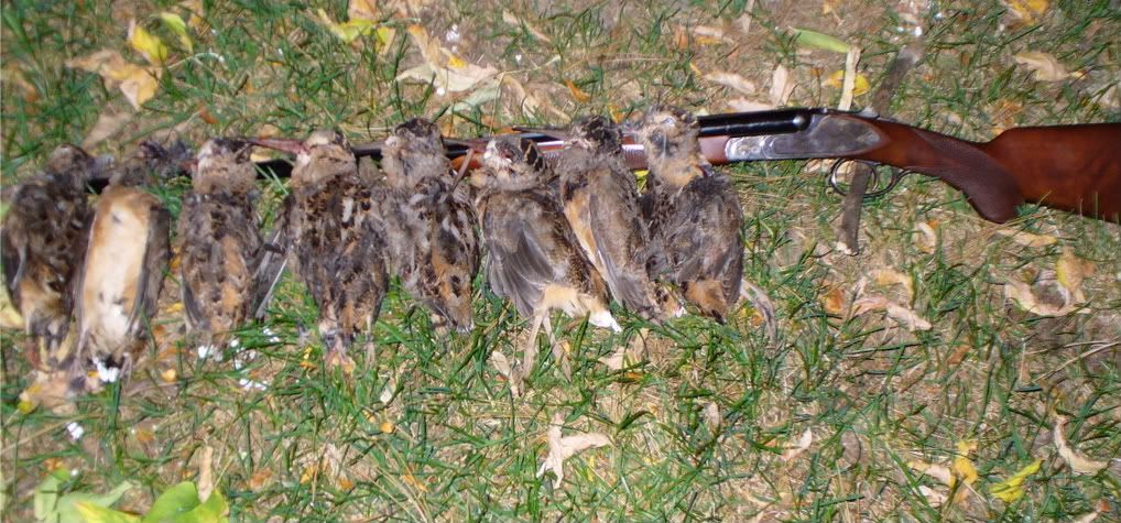

Well I picked up the 20 gauge "Ringneck" Huglo gun today. It is very nice and locks up rock solid. A bit too stiff yet. It weighs 7lbs- 1oz with 28" barrels.
Heavier than I thought. LOP is 14.5" about an inch too long for me. The trigger is single selective and gun has a single extractor.
The trigger pull is 8lbs for the first pull and
9lbs for the second pull. Trigger pull needs to come down at least 2.5lbs.
I thought it came with ejectors? Five screw-in chocks are included. I will give it a go on Sunday and shoot a few rounds of skeet. Shooting high gun I can manage the long stock.
The comb is a bit low and needs a 1/2" build up. I like to have the center of my eye about 3/8"+ above the rib?
The stock is stained very dark and hides the grain, which is very nice. So that stain has to go.
The metal is very nicely finished and the receiver is color case hardened with a small bit of engraving.
The checkered stock has a very pleasing rounded pistol grip without a grip cap.
The only complaint I have is the lack of automatic ejectors. I know it would add to the cost. But it really would make the gun
complete and put it in a different class.
Other than that this gun is one hell of a buy, if it stands up. Price is $1099 plus 6% sales tax.
The lock up has double under lugs and a Greener Cross-bolt. A-plus solid construction.
