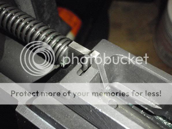

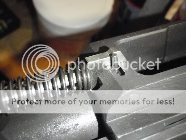

I dropped the NEA unit and the Norc op rod spring fits a bit shy of the spring recess. You can see that this is such an insignificant difference, but some of you M14 lovers will discover this and then think, "Hey, my #### will fall off... " :eek: No worries, man! Have a look at the picture:
Then compare the spring contact in the recess:
This is not an issue because everything works as usual. I was testing the travel of the op rod spring guide (both USGI and NEA Unit) and everything is perfectly fine! :D

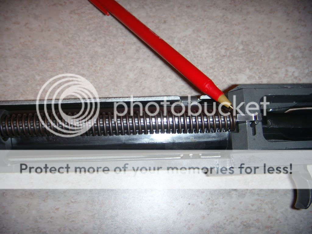

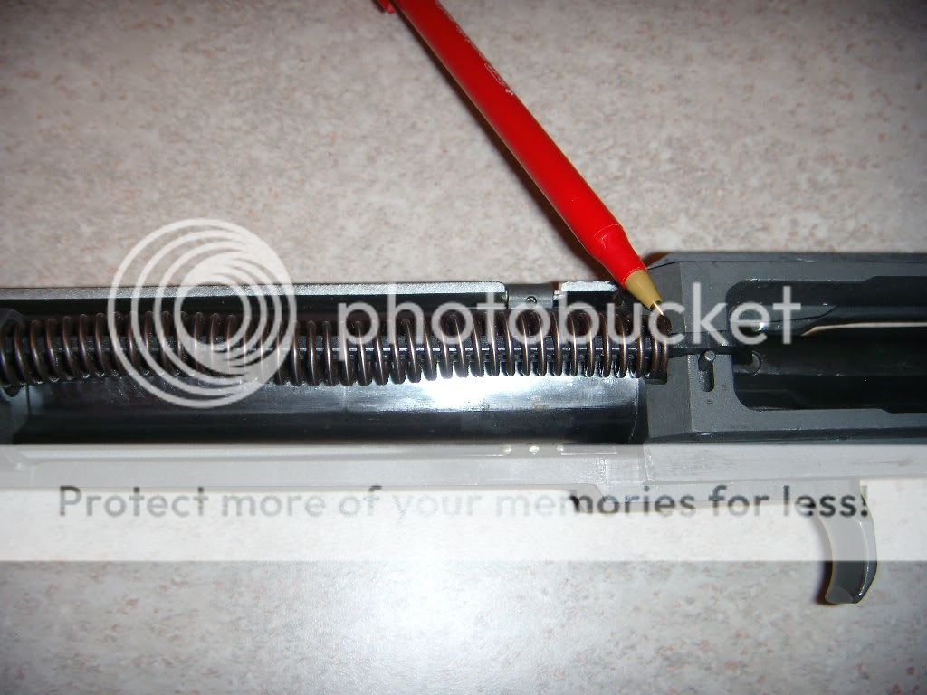

  • Did it wiggle alot by the tip of the op-rod? (Other side of red pen)
  • Side to side?
  • Up and down?
Side to side wiggle was snug with about a quarter mm of slack, just enough to allow it some fore and aft movement. I discovered that the movement was identical to the existing USGI Op rod spring guide. I guess that it's a good thing. I ain't an engineer, but a match shooter.

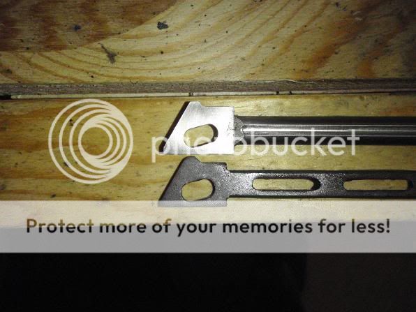

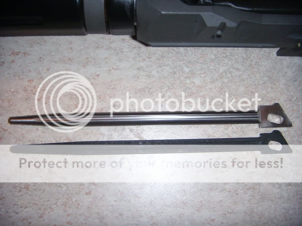

Hey,
I just got this oprod spring guide a little while ago and tonight went to install it. It went into the receiver fine but the retaining pin will not close unless the guide is fully forward in the channel. With the pin closed, the guide has almost no movement and is too far forward for a mag to hook on to. On comparison with my Norinco guide, it appears the NEA guide has slightly more material below the hole. Please see the pictures below.
I am just curious what I should do? I think I can file it to fit but I am not sure if I should if it is out of spec.
Some guide rods fit as you describe and when they do... Generally I stone the botton edge until the rod end fully seats and the pin slides un hindered.
However, you should still need to push on the rod during install to slide the pin in.
When it's all said and done and installed, when you push on the end that engages the mag, the rod should have some slight fore and aft movement.
This was very common with rauch guide rods and the occasional marstar. Not a big deal as even some drop in ready parts will need some minor fitting ;)

Ok cool. I just wanted to make sure before I started removing material.
I would use the GI-style rod as a template as to where to file. Go slow, try for fit often. Easy to remove material, hard to put it back ;)
