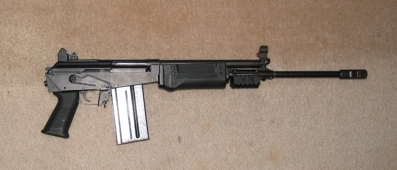

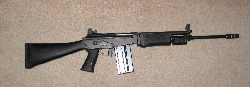

Nicely converted to a 223 Valmet / Galil mixmaster - notice the custom adapter at the rear of the receiver.... Also, the trigger is not moved forward......

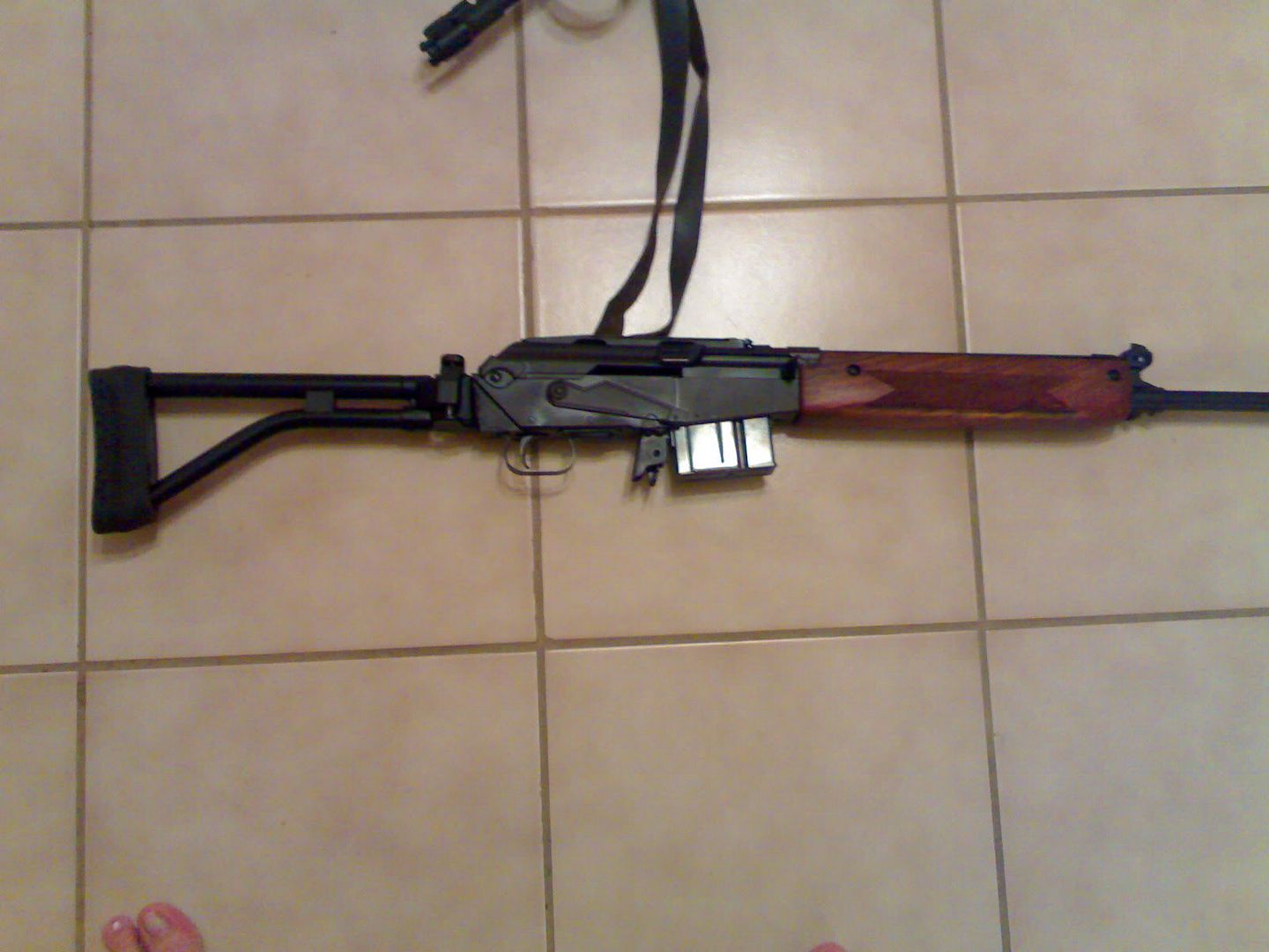

Another acceptable conversion - mostly Galil 308 - notice the custom stock.... the trigger has been moved to the correct position.

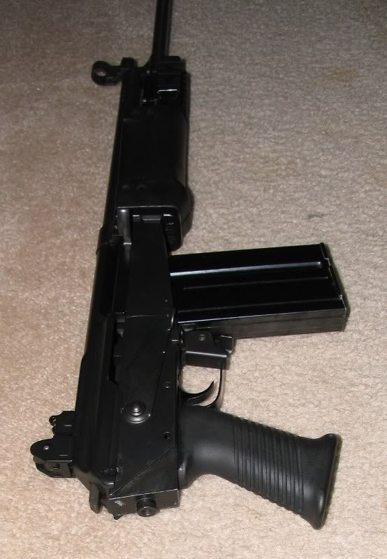

Closeup of the rear of the receiver which creates the problems with the Hunter..... the side cuts

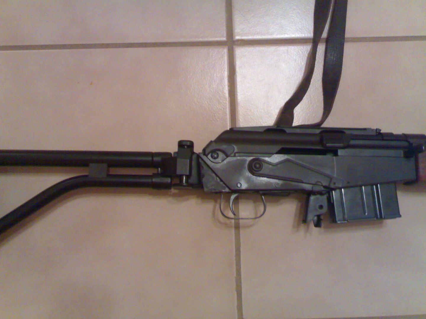

Mid-Conversion - Notice the trigger is in the wrong place and needs moving to facilitate the pistol grip - this is a mod to the receiver... (already machined)
