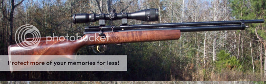

If you want to step it up "a bit", check out this prick!!
http://www.airgunsource.com/store/index.php?product=SY-DRAGONCLAW50D&c=63
Am getting this one below. Fired one this summer, and it is quite something.
Not sure of the velocity, but it was a 45 calibre, 450 or 500 grain slug that certainly created an impressive hole in the object I was shooting. They are available set up from 200 to 400 ft-lbs energy rating.
They also have a 30 calibre that would be perfect for small game, and they also have a 58 calibre for hogs, deer, etc, that goes up to 750 ft-lbs. (10mm Auto = 650 ft-lbs, 44 Mag = 1,000 ft-lbs)
As for "regular" airguns, you are going to need 25 calibre for anything larger than squirrels. If you want raccoon, well, none of the conventional 22 or 25 calibre are sufficient, the pellets are too light for any decent penetration, and you will wound, (or annoy) raccoons.
Have several high powered 177 (RWS/Diana 52, side lever), and they are NOT quiet. No way around it, they are supersonic. A 22 or 25 will be quieter, as they are not supersonic, but still louder than a CB cap.
