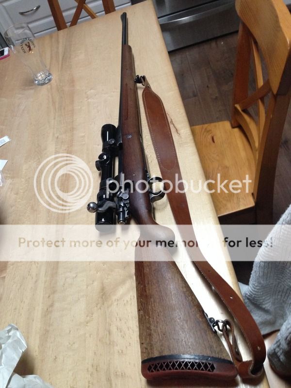

There have been many threads on this topic and truth to tell, I was looking for one of the recent ones but couldn't find the forum it was in. Well, I decided to post my own and toot my own horn a little. Some background........thanks to a very good friend, I have a place to hunt in the Minden/Haliburton region. Only one spot has 125+ yd. line-of-sight so most deer engagements are 40-70 yd. Some time back, I'd purchased a "Sussex" English No.4 sporter and decided to tweak it to suit me. I fabricated a scope mount (which works like a charm), mounted a rail, mounted a scope, fabricated a cheek piece to give me an instant sight picture, and commenced load development for deer. Before you laugh, yes, I know it looks awkward BUT every shooter who laughed at it stopped laughing once they shouldered it and acquired the sight picture. Appearance means bugger all and it always comes down to "how does it shoot". You be the judge.

Nothing to snicker at , I used to hunt with a bubba no4 for a while and now switched to a sporterised Churchill again a no 4 .

Why not put a proper over the action scope base on it and a regular scope?Other than having to alter the bolt.......Harold
Looks to be a neat rig. Nothing at all wrong with either the round or the rifle. We are so mesmerized by the newest and flashiest high-tech announcements that we tend to forget that the .303 in a surplus Lee-Enfield was more-or-less the most common big game setup in Canada for decades. It worked well 60 years ago and, unless Bambi has somehow grown Kevlar, it should work every bit as well today.

Tell me more about this homemade base. Piece of Angle?
Roger that! Cut 'er down, polished and blued it, and shaped it to fit around the ejector screw head, then drilled and tapped in 3 pan head allen screws. I ran a piece of dental floss from the fore sight through the back sight to establish center line, marked it, and then got a scope base for a Marlin 336 (they have a flat bottom), mounted that, got my scope, Millett adjustable rings, bore sighted the whole shebang and I was good to go.
