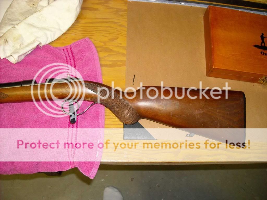

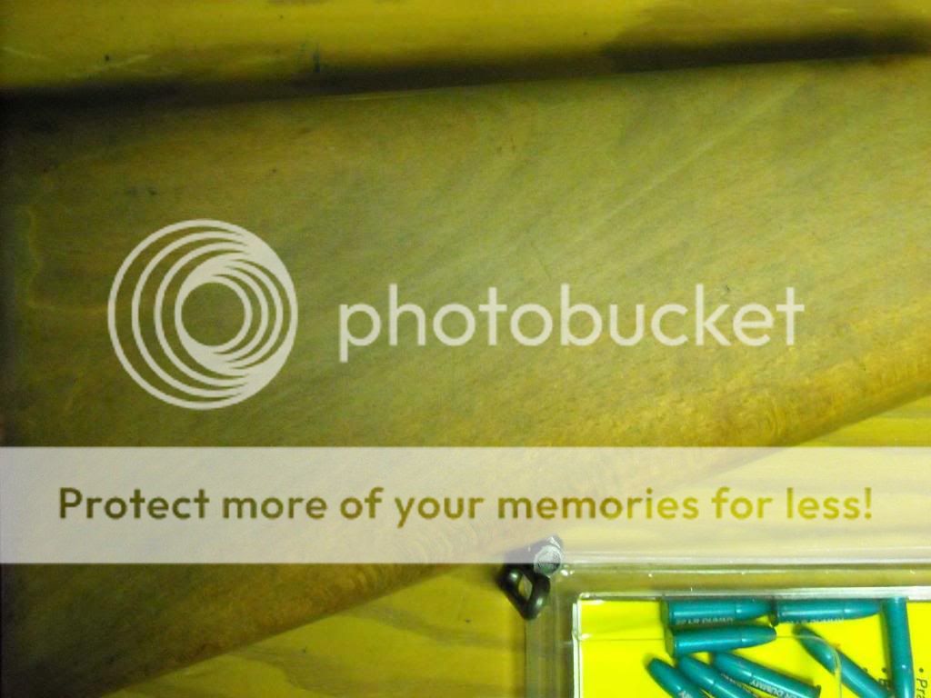

Here are the pics of mine.
Before cleaning:
The pictures don't show the junk on the stock very well. I wasn't going to mess with it right away but I got sick of it after seeing it against the clean barrel.

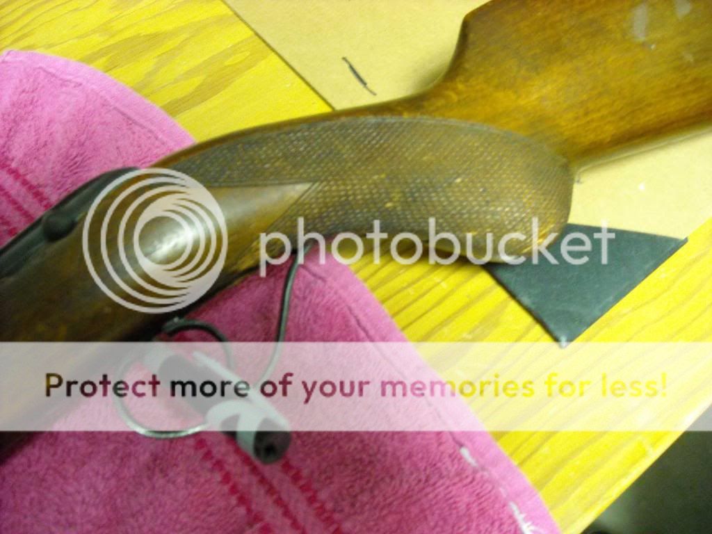

The worst of the chips in the stock. Seems like someone tried to take the trigger guard and plate off by prying against the stock. It was on pretty tight, but simply required a few taps from the dead blow hammer while you pulled on it.

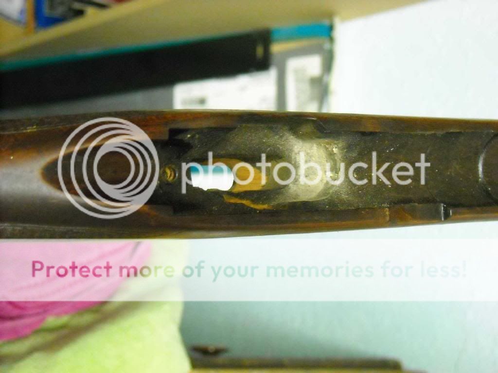

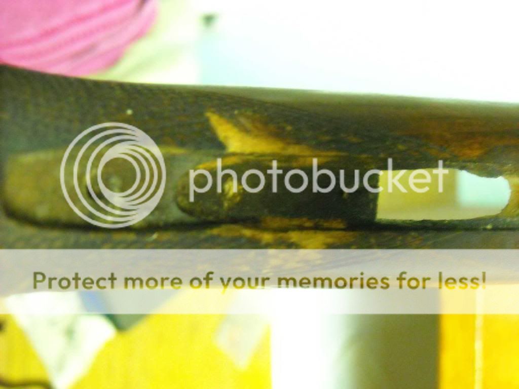

I have no idea what that white stuff was. Some sort of buildup or attempt at bedding? Almost seemed like some sort of ash.
You can see where the white stuff was touching the action.

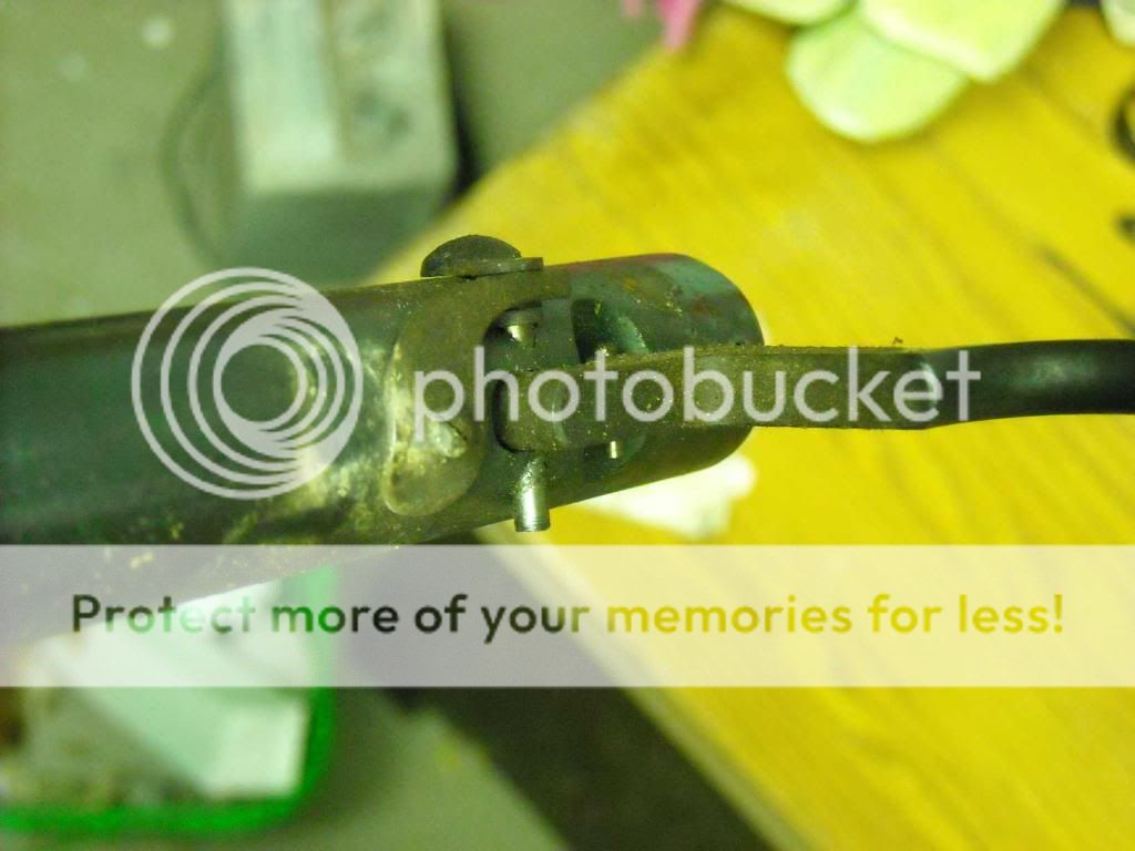

The rifle was very dirty when I got it. Crud all over it, in the action, and on the stock. The rifle wouldn't extract rounds due to the buildup in the port the extractor settles in when the bolt is closed. I'm just glad I didn't try to fire it in the state it was in.
I didn't get pictures of it but the bolt itself was sticky with crud. The bolt handle was so bad that I can't get it any cleaner then a dull brown. At least it looks better and isn't sticky.

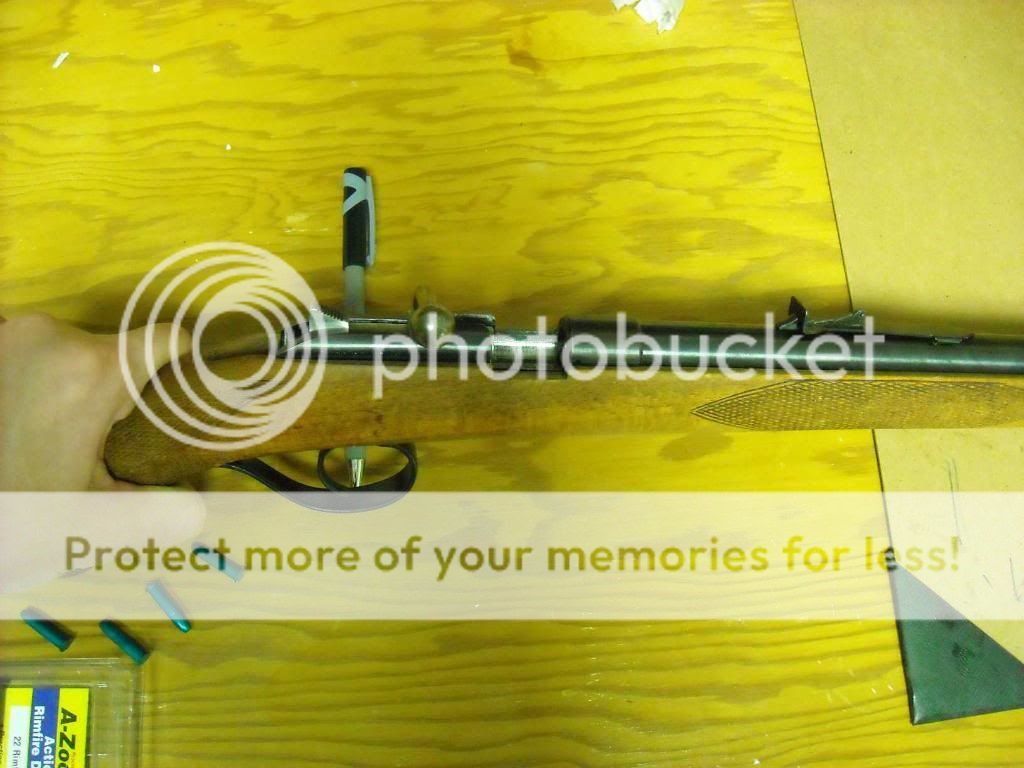

After Cleaning:
I striped the rifle down and went at it with a nylon brush, rag, Hoppes #9, and Wipeout for the barrel/breech. This was pretty easy but when I got to the bolt I realized it was pinned together and I couldn't get inside it. I'm not sure if the bolt is even suppose to come apart, so I just cleaned it the best I could.
The barrel and trigger came very clean. The blueing is still strong, and short of a few scratches I'm very happy with it.
For the stock I used a very soft sponge along with some wood cleaner (but not stripper). The stock was thick and black in many places but it washed off well. It will need refinishing, but it looks so much better.
