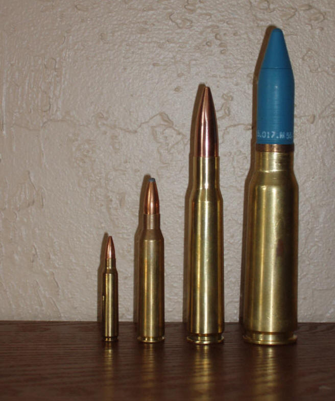

Quit kidding around with that 338...puny for long range
From left to right: .223, .338 lapua, 50BMG, 20MM Vulcan
20MM is best for beginners
