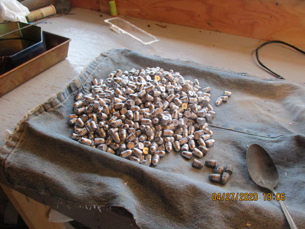

From a few days ago. 45 acp 230 grain. I will powder coat them.
